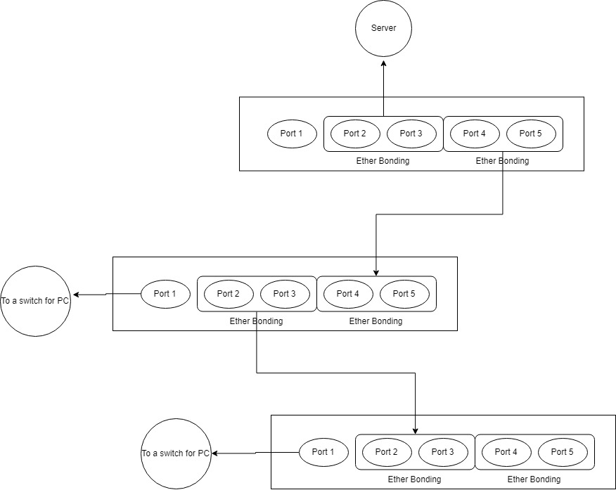

I have a strange question, because i have a strange situation.
I need to know if I am doing it right.
There is some place where I cannot run fiber. and the data that needs to go is more than 1.5 gbps (video files need to be transferred). Again, fiber is not a choice for me unfortunately.
Please check the attached picture. I am planning to use HEX GR3.
Moreover, how about bridging on top of bondings to make them act like a switch?
Regards,
When it comes to bonding you should be aware that single IP connection won’t be able to use more than one physical link from a bond. Depending on bond setup it might happen that all IP connections between single pair of hosts (i.e. one client, one server) will share single physical link from a bond.
OTOH, after you construct a bond, the bond device acts similarly to any other interface (so it’s can be a member of a bridge).
Beware that bonding is a CPU-only functionality on hEX and can not be HW offloaded. Meaning that even if CPU is capable of pushing around those gigabits, the CPU-ether ports interconnect will be a bottleneck (that’s 2x1Gbps full duplex) … you’ll have to consult block diagram to make the best out of the tiny device.

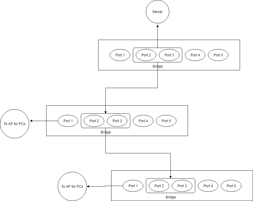

How about I create a bridge of just 2 ports. 3rd port will be connected to the AP. The AP will run a hotspot to only allow the specific user.
Suppose the Hex in middle, the user pc will fetch data from the server via port 1, other ports in the bridge will switch the data for the next hex.
Whats your say on that ?
Regards
If you want to run L3 services (hotspot, DHCP server, firewall, …) for APs on each hEX, then your idea is right.
It is more usual to have L3 services centralized as it largely simplifies management though.
Check the diagram. So this is what I want? the port on which the AP is attached is running hotspot. Bridge is just passing data to and from server.
Please do comment.
I would go with this solution:
https://mikrotik.com/product/s_rj10
Seems fine to me.
