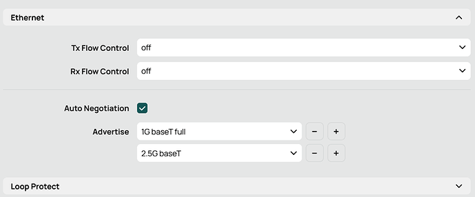

I have a MikroTik S+RJ10 RJ45 SFP+ 10GbE copper module running on CRS309-1G-8S+IN. Due to high temps at 10G, I wanted to downgrade Ethernet to 2.5G baseT:

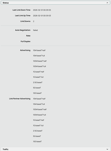

But, for some reason, the module keeps advertising 10G baseT, eventually failing to negotiate. What might be causing the issue?
