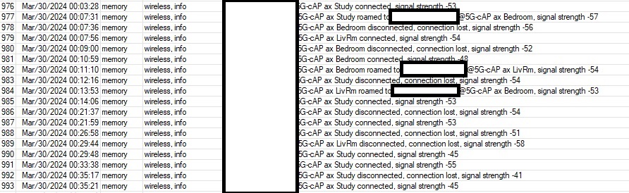

Here’s a snapshot of my log:

Yeah after reading your post again I figured while the log messages being displayed are the same I think the underlying issue is different. I was having trouble with wireless windows clients going into power saving mode and that disconnected them. You seem to be having an issue with Ethernet connected internet access points disconnecting from the main router.
While I think these issues are not related, I am cross-posting a new thread: http://forum.mikrotik.com/t/intel-mimo-power-save-mode-issues/175493/1 with more info about my issue in case anyone in the future stumbles in here and wants to know.
