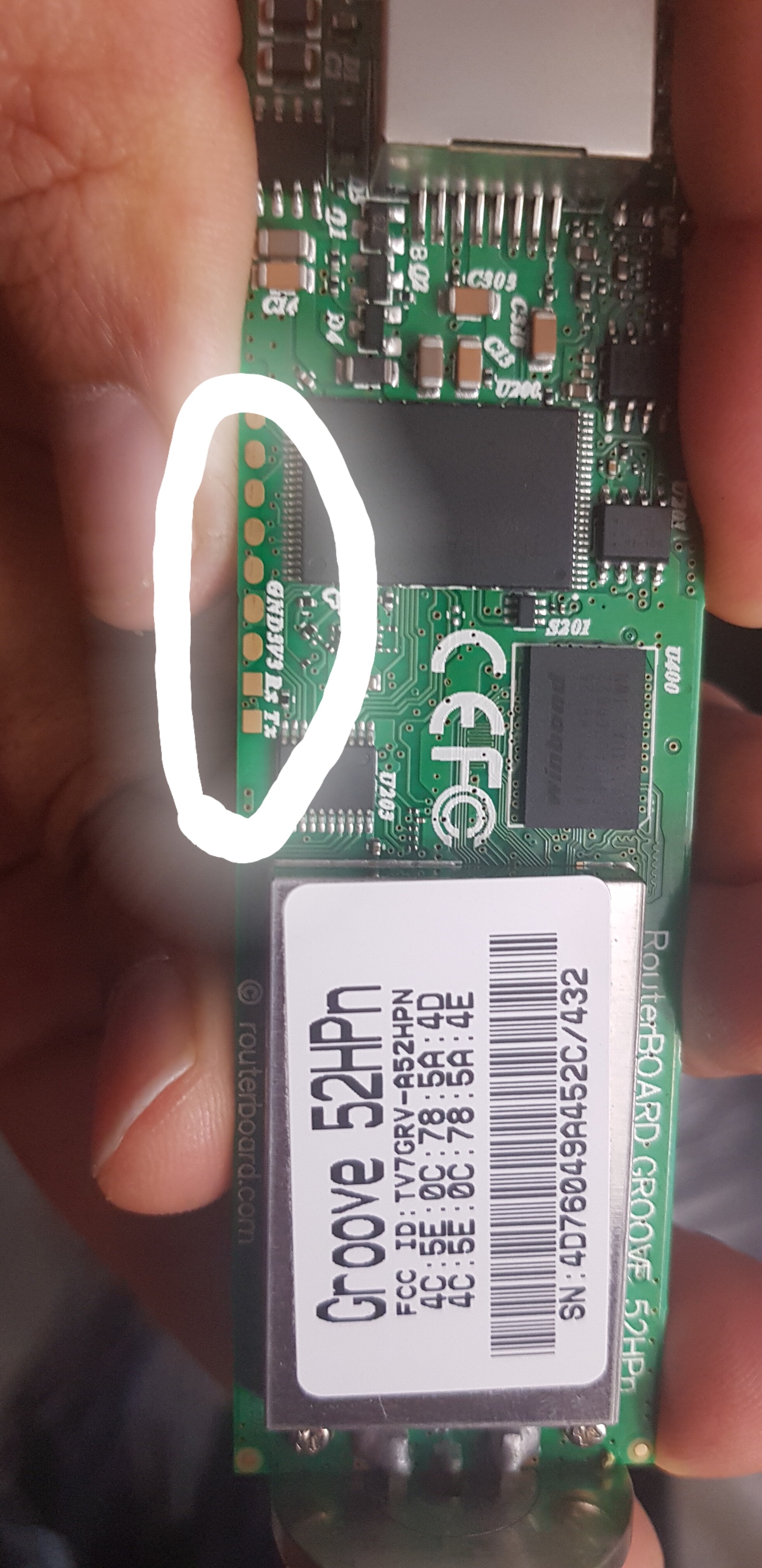

i have a another question .i take a picture in attach and in white circle there multiple pads . what are those for ? are they using for serial port ?

Unfortunately I cant provide info about those metal pads on the board and based on the silence of others, I guess they have no idea either.
