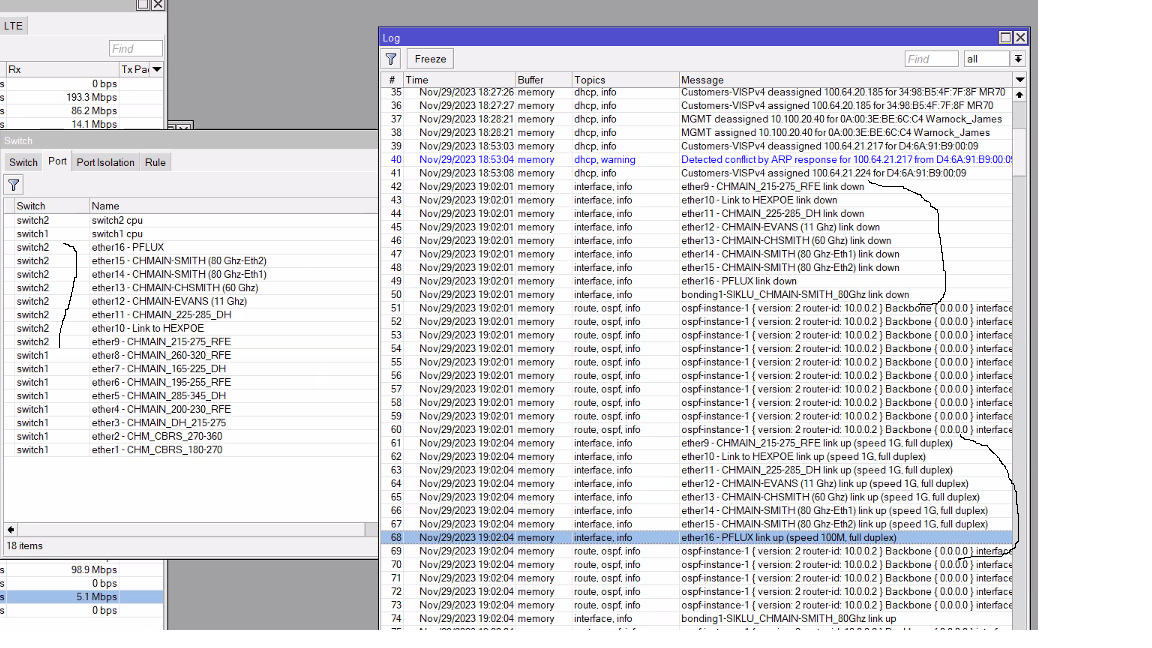

I want to tell the same story with CCR2004-16G-2S+, RouterOS v7.12.1.
Half of the ethernet ports are simultaneously going down at the same time for a few seconds. That happens with ports that are located on switch 2 inside the Mikrotik. please see the attached image.
  1. mohand1989, could you check if that happens with all of your ports or if it is related to ports on one internal switch?

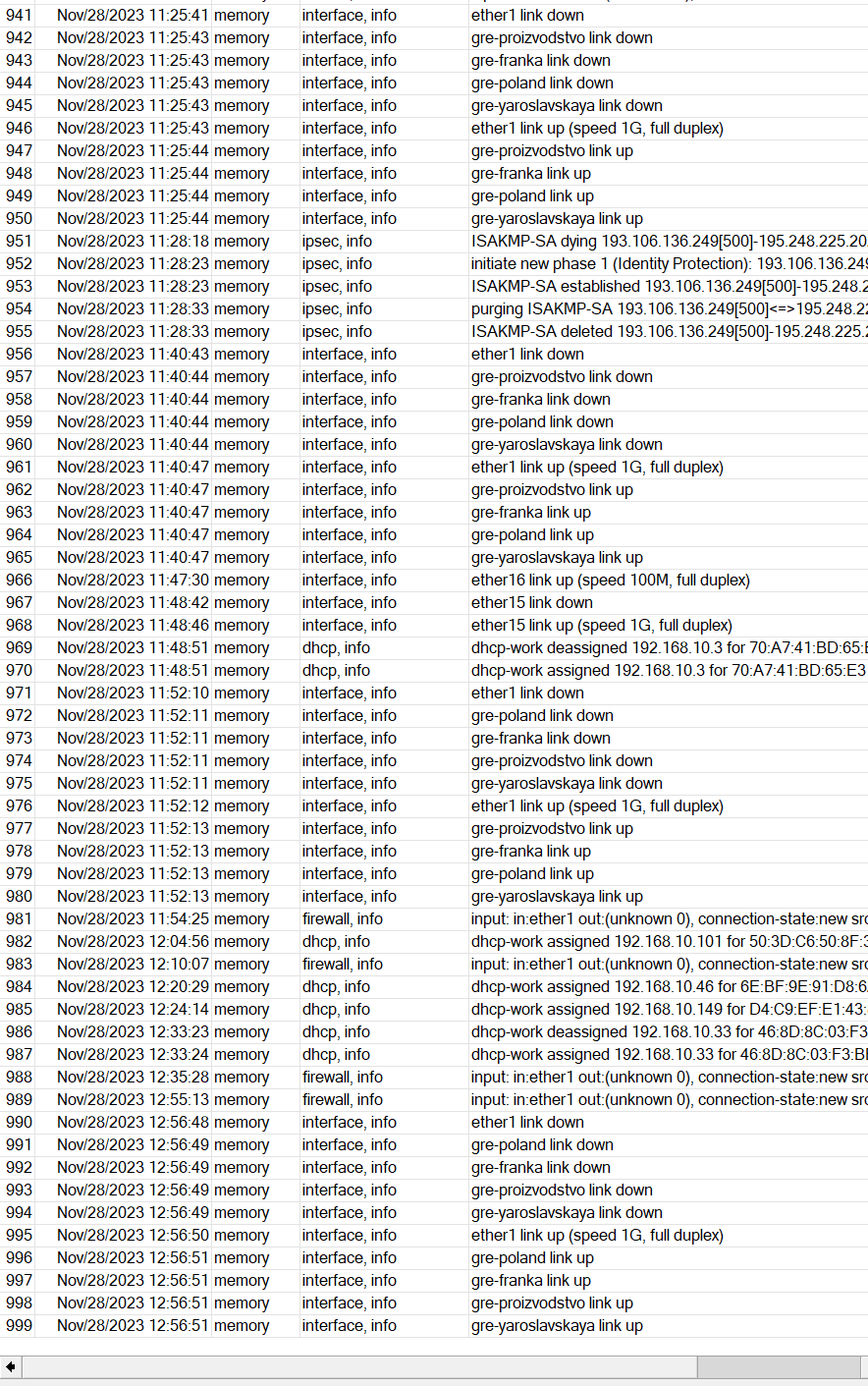

I get same issue with my rb5009 on 2.5G port, do you have any idea to fix it
Same issue on a brand new CRS312-4C+8XG-RM aswell, both on 7.13.3 and on 7.13.2. On 7.13.2 it worked fine for about a day before it started happening, on 7.13.3 the links started to go down/up after 5mins.
