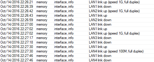

I have RB951G-2HnD (v6.37.1, fw3.33), which has five Gigabit Ethernet ports.
The ether1-4 (my WAN, LAN1-LAN3) sync on 1G normally.
But ether5 (my LAN4) sync only on 100M (and negotiation takes longer).
Attached screenshot shows log when I move one cable from ether2 (LAN1) to ether3 (LAN2)…to ether5 (LAN4).
If I select to negotiate only 1G on ether5 then computer is not connecting at all.
Is my router faulty? Or what can be the cause?
Thanks.

Have you tried replace the cable? If there are not enough copper wires in the cable, gigabit will never work.
I use only CAT6 cables.
For test I connected only one computer which negotiates with ether1-4 on 1G but when I move that only cable to ether5 it negotiates on 100M.
From my logic this cannot be caused by cable or connected device. Anyway I tested 3 gigabit devices and few cables with same result.
1G does use all 8 wires where 100M uses only 4. Take a flashlight and see if one of the wires in port 5 is 'off track" of dirty. Otherwise something may be burned out for one of those wire paths for that port and can’t be fixed economically.
The ether5 connector looks perfect, same as others ether1-4. So it seems it is hardware failure.
It is still in warranty, I will contact my dealer to exchange device.
