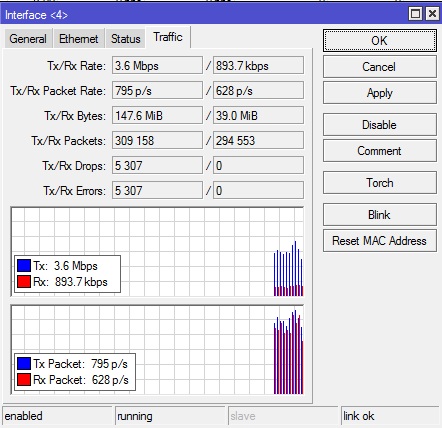

so that will also do the error on the tx as the pic shows as i played around with cable hardware and cards etc
