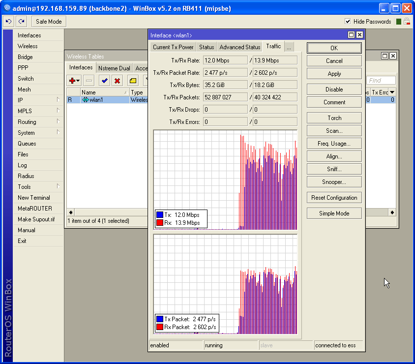

Attached here is a screen dump of a 2-way 248 Megabytes file transfer, from local to remote and from remote to local.
I think that peak rates can be seen clearly.
Comments welcome.
the limitation is your testing method. one TCP file transfer can’t go faster because of itself. You need to make several simultaneous transfers to consider this a test.
Thanks.
Putting 5 different instances of transfer remote vs. local, files from 150 to 250 MB, ethernet rate goes up to of 61 Mbit/sec peak, realistic average lies around 45 Mbit.
Under such conditions cpu is used near 50%.
Further transfers does not increases rate.
