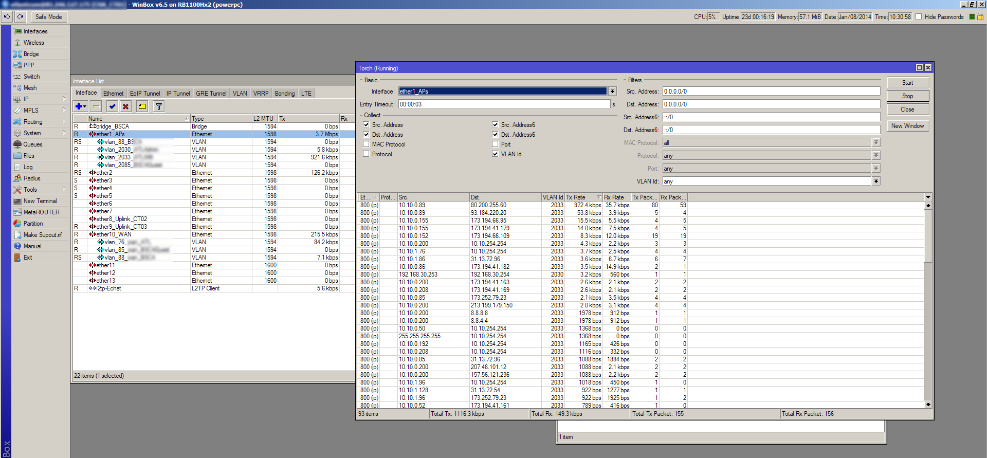

I have a RB1100Hx2 acting as hotspot controller for a 50ish APs, using different VLANs (3 hotspots and 1 admin). I have noticed that the global traffic on interface does not match the VLAN traffic, and i don’t understand why.. see picture attached.
Sum(VLANs) in eth1 traffic ~= 1Mbps
total eth1 traffic ~= 3 or 4Mbps.
Where are the missing 2-3Mbps ?

Check if some trafic passtrough the untagged ether1 interface. The SUM you said is the SUM of the parent interface + sub interfaces. The difference between the parent interface - SUM(each sub interface) are the Untagged traffic.
Well i have no address assigned to ether1, therefore i should not have any untagged traffic.. How can I check this traffic?

The IFace trafic is independant than the IP Address. Refer to the OSI Model, I assume than the Interface counter are the Layer2 Frames and not the Layer 3 (packets). So it doesn’t care about the Ip address. Like PPPoE. The Interface where is listening the server PPPoE should show you in outbound (EGress) the total packets aggregate for all active session.
I said, it should…
