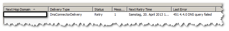

Well, it’s definitively not the NAT pin holes. I deactivated them with no success.
I attached a screenshot with the Exchange queue.

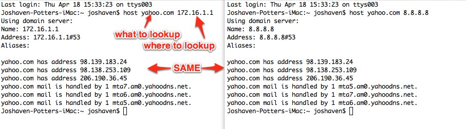

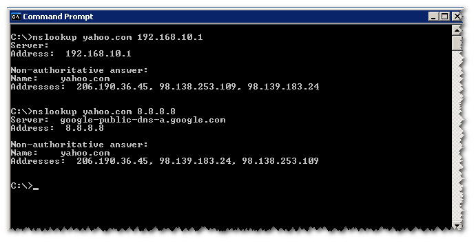

As far as testing the DNS Caching features of your routerboard you can use nslookup (on windows) or host (on mac or linux) to do manual queries… you should be able to query your routerboard as well as google’s 8.8.8.8 and get the same results.

routeros dns server does not only reply mx records when asked for this type. it also puts all other types like a or ns in the response. exchange server gets confused with this. there is a setting in the outgoing tranport to use external dns server. this will solve the problem but dont ask me why.
Can you show an example of this? I am seeing that the MX record report from my MikroTik is exactly the same as Google’s public DNS
Here is a query for type mx against my home RouterOS RB2011:
Joshaven-Potters-iMac:~ joshaven$ host -tmx mikrotik.com 10.70.99.1
Using domain server:
Address: 10.70.99.1#53
Aliases:
mikrotik.com mail is handled by 10 mailgw.mikrotik.com.
mikrotik.com mail is handled by 50 mailgw2.mt.lv.
Here is the same query type mx against Google’s public DNS:
Joshaven-Potters-iMac:~ joshaven$ host -tmx mikrotik.com 8.8.8.8
Address: 8.8.8.8#53
Aliases:
