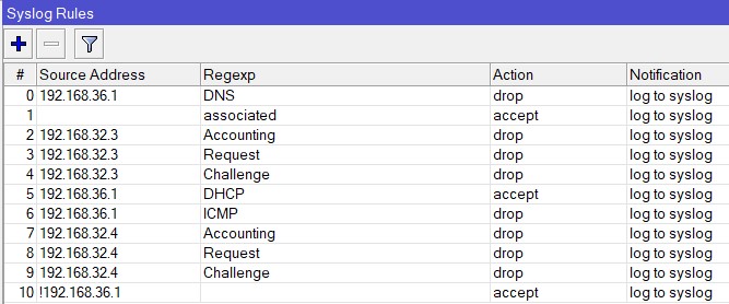

Or send your log to syslog [action=remote] (you can add a Prefix also)
(eg DUDE has syslog functionality and Syslog Rules that filter on source and Regexp content)
(this filtered syslog content can be logged as log topic “dude”)

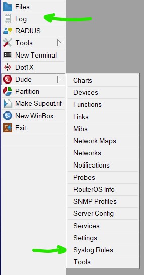

You don’t need DUDE client to setup and look at DUDE. You do this in Winbox (or even webfig)
DUDE menu en Syslog Rules setup for DUDE are also in Winbox
Just as the LOG is in Winbox, including it’s filters when displaying.

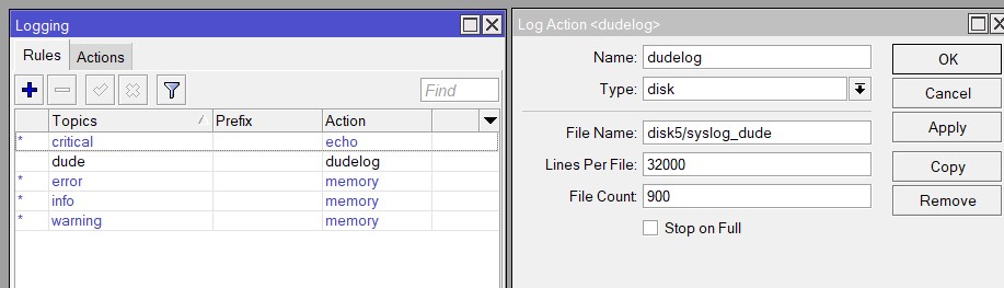

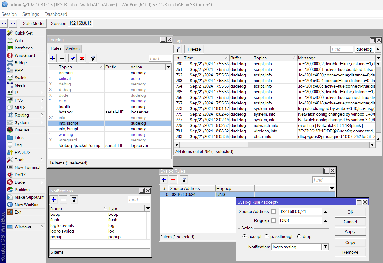

Having a hard time getting Dude’s syslog filtering (using Syslog Rules) to work.
Using /system/logging, without an entry that includes certain topics with an action of DUDELOG, the only entries in the dude log are dude-generated entries such as “syslog: Service ssh on 192.168.2.5 is now down (timeout)”

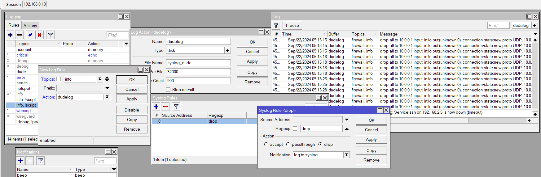

But, when I include an entry in /system/logging such as “Topics: info” “Action: dudelog” then all info topic events show up in the dude log, regardless of a syslog rule such as the regexp “drop” fule shown:
What am I doing wrong?

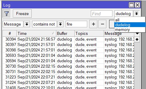

You can select what buffer is shown in Logging: eg dudelog, memory, all … selection in that upper right field, now set as “dudelog”
Use buffer selection “All” for combining buffer dudelog and buffer memory in the LOg display
