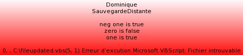

I make a screenshot of the result in the device appearance (cf. picture). The -1 handed back the execute command return a positive result, I try with this command but it didn’t work:
if(array_element(execute(“cscript.exe”,concatenate("//NoLogo C:\fileupdated.vbs ",device_property(“CustomField1”)),“C:\WINDOWS\System32\”),1)=“1”,1,0)
In the picture Result.jpg (attachment file) the last line is the result of this command:
This return an error with file missing! Strange!
I can only guess that the dude is not executing the VBS correctly.
