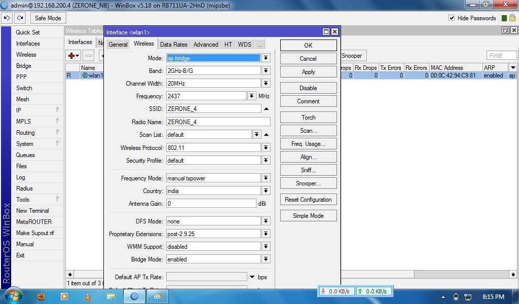

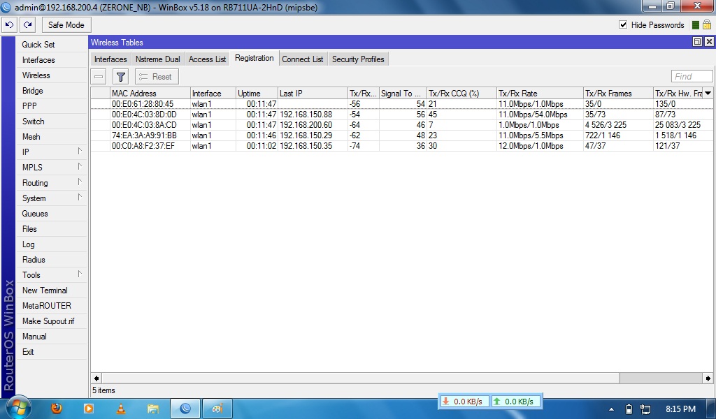

I used 2.4 airmax mimo antenna with R52hn card with 433 ah, from last month im getting latency issues, when i watched over winbox i found packet in TX frames only. by comparing Tx/ rx frames with Tx/Rx Hw. Frames.
Now i changed with 711 UA 2hnd & Lmr 200 cable , then also im getting same problem
here is my registration table, signal strength is good , but lot of packet loss in Tx Frames only.
my client are having mixed cpes, so i used b/g/n mode.
here is my config.

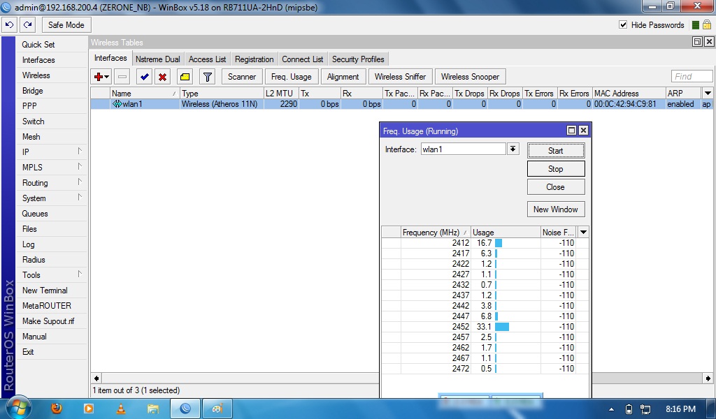

the freq usage of my area ,having no problems with frequency
Help me to get out of this situation…
