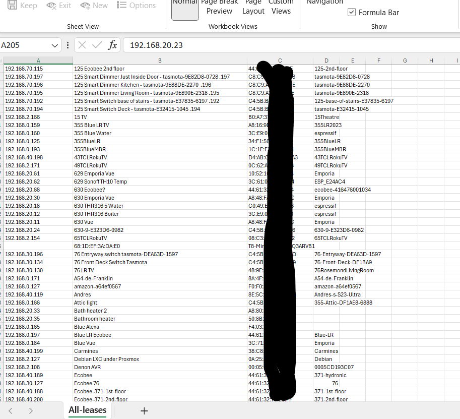

In another thread ( http://forum.mikrotik.com/t/why-is-this-so-hard/172569/21 ) I sought and received helped that allowed me to create a script to export all DHCP leases with comment, in CSV.
I then used a Windows Powershell script to concatenate and clean up the files from the individual MT devices.
I can now open this file directly into Excel. Here is just one page of it:
Can someone suggest how to go about collecting non-DHCP-IP-assigned devices? (To be clear, I mean devices where the IP is set on the device; the DHCP server has no clue about them.)
