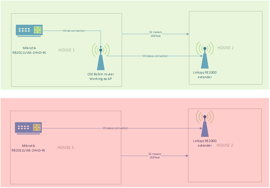

Cable connection is not an option, because I try to connect 2 houses… see in picture…
In the picture you can see my current situation… the green opiton is currently working, the red option is what I want to do :slight_smile:

Ok. What throughout are you expecting for devices connected to the repeater? Probably the budget is also important. So why not keep it as it is if it works?
The working options is just a temporary solution, “Belkin AP” is not mine, so I need to buy a new one if I don’t connect the extender directly to “mikrotik router”. Buying a new extender or a new AP is not the problem at all, I just wanted to connect the extender directly to “mikrotik router”. I that way I would have 1 device less to manage.
When I will have a chance to connect the devices in that way as in the red options, I will post the log results, but the owner of “house 2” is not available right now.
In the meantime can I provide you any additional information?
