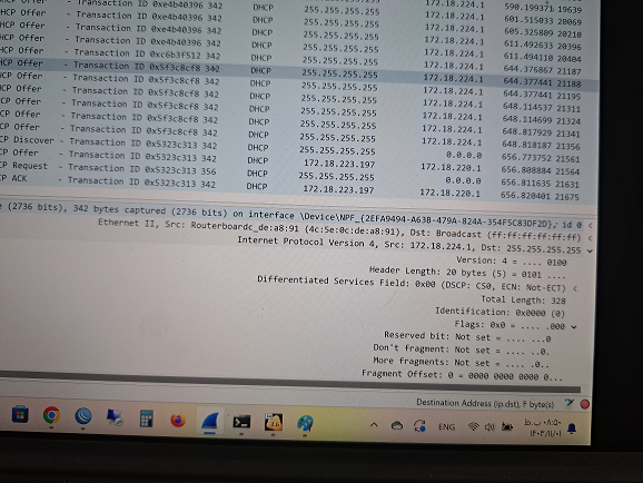

I have a network that I will send you a photo of.

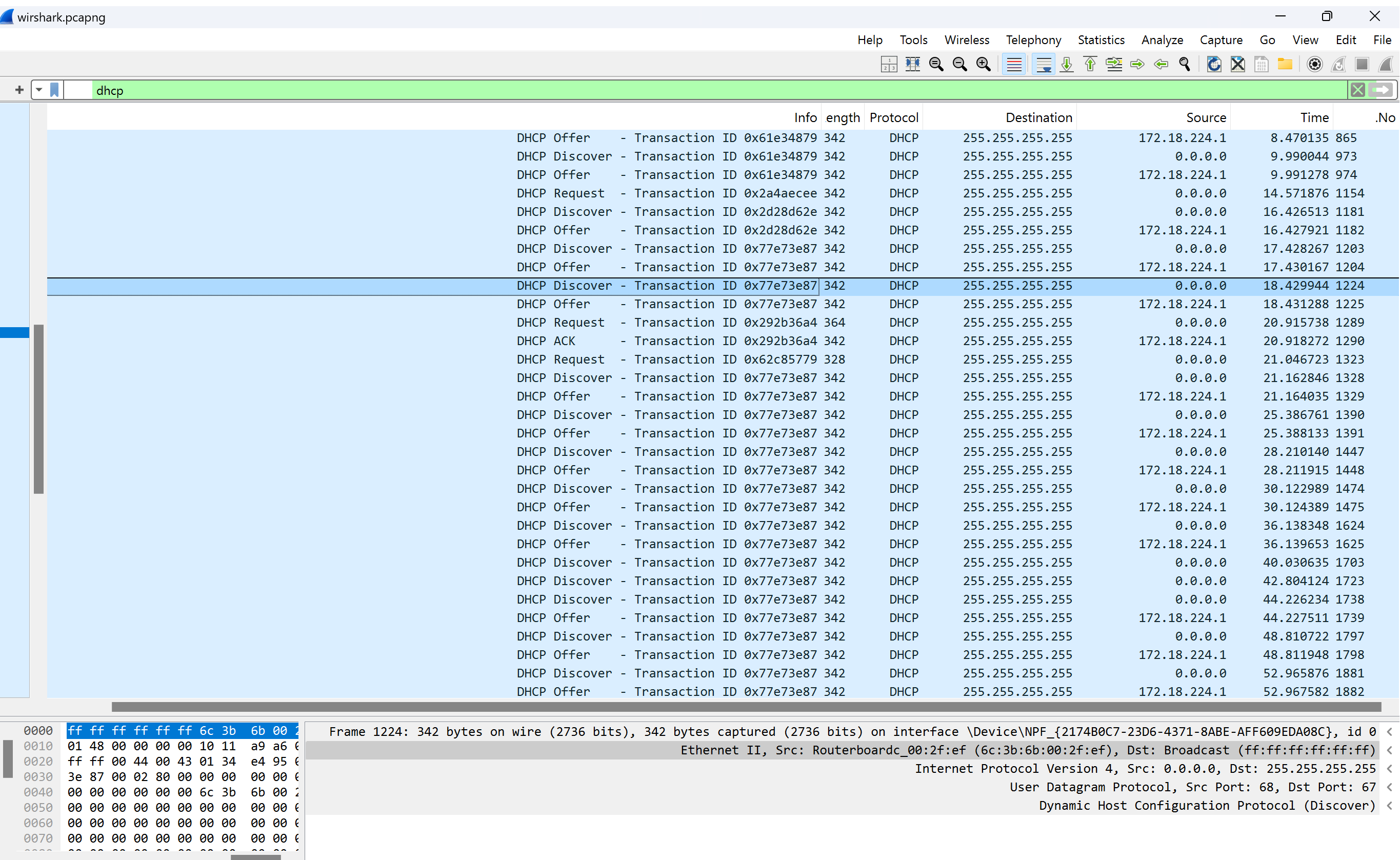

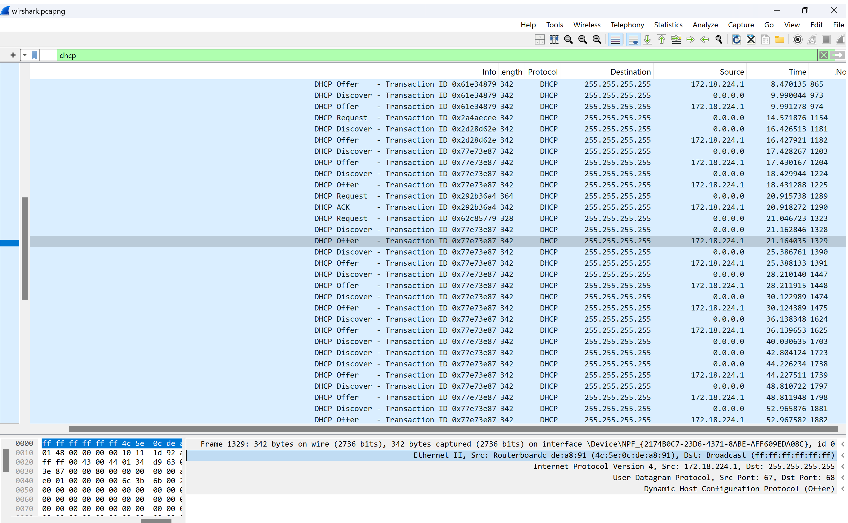

I will also send the Wireshark image

Does anyone have information about why the DHCP OFFER packet is the source instead of the MAC ADDRESS.
dst: dhcp broadcast is set, in fact, the dhcp steps are not done correctly
In the second step, dhcp offer must be sent unicast ؟

In the first one, the dhcp offer is sent as unicast and correctly, but in the second one, which has a problem, the dhcp offer is sent as broadcast, and I don’t understand this!!
172.24.224.1 not ok
172.24.220.1 ok

Currently, the problem and question is how to make dhcp offer
It is not sent in unicast mode and it is sent as broadcast?
Pay attention to the previously posted image

Sent by which device?
The CCR, right?
So there are two possibilities:
  1. the CCR sends it as broadcast.
  2. one of the devices between the CCR and the end devices captures the dhcp packet and re-transmits it as broadcast.
It still seems more probable #1, but fixing the AP configuration, cleaning it from what is not needed still remains a good idea.
