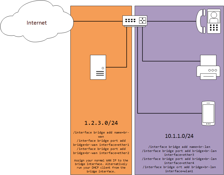

You have to remove that one ethernet port from any bridge or switching (master-port) and then configure that ether to their type of connection, i.e. DHCP, PPPoE.
This is one way to do what I think you want. You would adjust your source NAT to have out-interface be the bridge.
An alternative would be to perform 1:1 NAT between a public IP and an internal IP.
