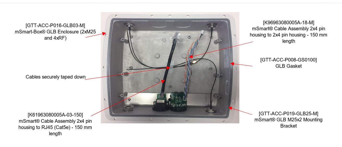

We are looking to mount an RBM33 with an R11e daughter board into an external enclosure but would like the ability to access the sim card without opening the enclosure up.
I have come across a manufacturer that make an ideal case ( GTT Wireless ) and they offer an external Sim adapter but it seems to connect via a bunch of wires rather than a ribbon cable which simulates the sim card and i’m pretty certain the R11e card won’t support that.
Has anyone used an external sim adapter successfully with an R11e card that ideally would fit into a M25 port? or have any other ideas on how to achieve an external SIM port.
