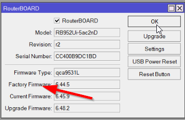

Hi guys, first thank you so much for all your replies.
Maybe I wrote wrong but I would upgrade factory firmare as attached picture.
Is it possible?
Thank you,
Marco
Just click on the “upgrade” button
No, the info you marked is immutable. In practice it’s used to determine earliest version of firmware that can be installed on a device (yes, it’s possible to downgrade firmware).
And same principle applies to RouterOS itself (in System → Packages …)
What you can (and should) do is hit the “Upgrade” button, which will bring the “Current Firmware” to version listed under “Upgrade Firmware”.
