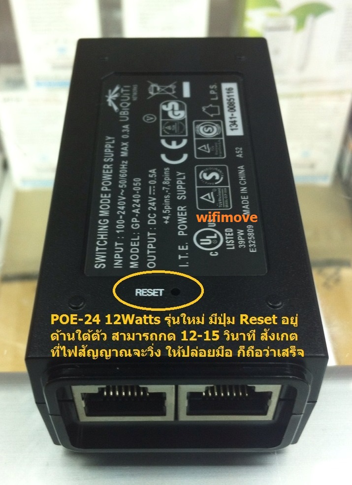

Why there is no factory reset button in mikrotik POE like UBNT devices

The difficulty lies you must download the widget from the tower to reset the factory why not upgrade the reset button from the Poe
like this
It is very annoying not having this option in your machine
yes we need reset button in poe injector rather than main device reset button like other Aps products plz.

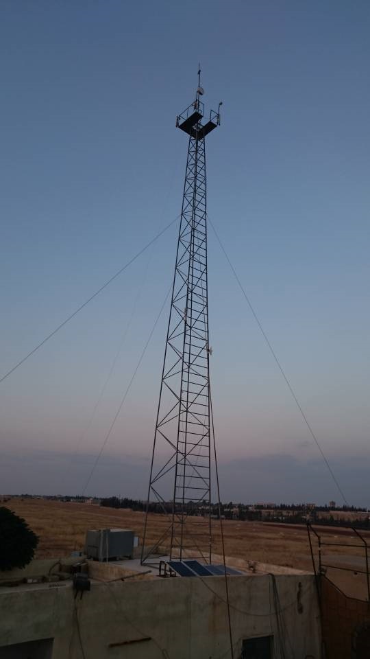

The problem is that you get the piece in a high tower and you have to step up and do a factory reset. This is dangerous. Sometimes rb lhg has problems. It has a lot of problems, so it does a sudden reset and sometimes needs to be accessed. My English is not good
You can produce a similar piece of poe ubnt as an extra piece only when you need to reset it without having to climb up to the tower
my tower in pic
