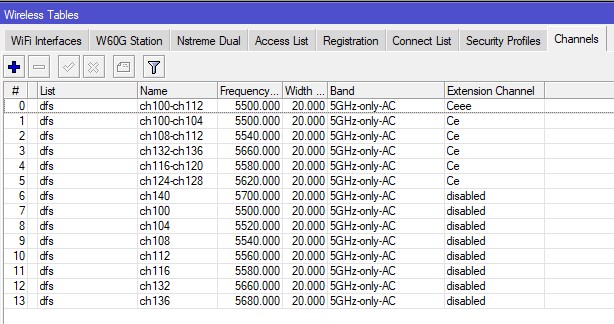

Just FYI, this is my personal list for DFS channels, avoiding 10 minutes outages unless it’s the only option. The manual entered frequency will be the starting point in the list.
But it will not solve your radar detect problem however.
