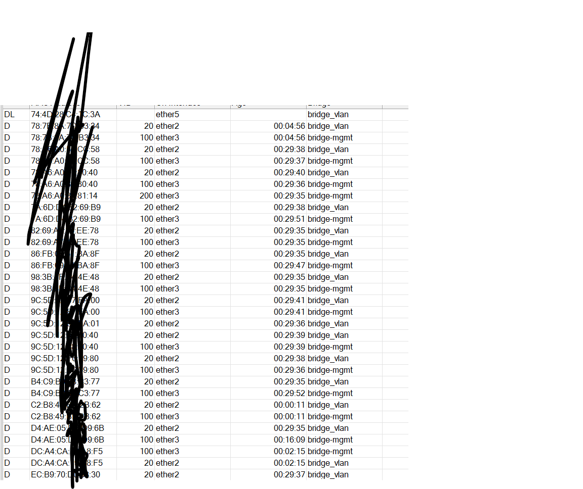

Currently my prolems that when i create a hydrid port (My mikrotik port 3 Trunk → Switch Ruijie 209 Trunk-> AP 230 with 2 ssid vlan 200 and 300). i see that in host many flap mac-address between 2 bridge (bridge-mgt for trunk port and bride-vlan for access port).i have attach the config below with the picture.

Well I dont see the need for different bridges, as the vlans provide all the separation required at Level2 and firewall rules at Level3.
That being said looking at your issues…
add bridge=bridge_vlan frame-types=admit-only-untagged-and-priority-tagged
interface=ether4 pvid=40
interface=ether5 pvid=50
interface=ether2 pvid=20
add bridge=bridge-mgmt interface=ether3 pvid=100
/interface bridge vlan
add bridge=bridge_vlan tagged=bridge_vlan untagged=ether2 vlan-ids=20
add bridge=bridge_vlan tagged=bridge_vlan untagged=ether4 vlan-ids=40
add bridge=bridge_vlan tagged=bridge_vlan untagged=ether5 vlan-ids=50
add bridge=bridge_vlan tagged=bridge_vlan vlan-ids=30
add bridge=bridge-mgmt tagged=bridge-mgmt,ether3 vlan-ids=200
add bridge=bridge-mgmt tagged=bridge-mgmt vlan-ids=100
add bridge=bridge-mgmt tagged=bridge-mgmt,ether3 vlan-ids=300
Everything looks correct to me except using a VLAN that doesnt exist.. I always manually insert my untagged vlans so the only difference is (but yours is also correcti)
add bridge=bridge-mgmt tagged=bridge-mgmt untagged=ether3 vlan-ids=100, however as we know vlan 100 doesnt exist… but lets talk about that next line.
The issue is you are trying to mix apples and oranges… All the VLANS need to be part of the bridge as their interface when defining them.
ALSO what is with the .100 networks which vlan is that? Not only do you have two bridges unnecessarily but then are you attempting to have a bridge give out dhcp besides vlans… Makes things more complex than required… As per the hint of what you were thinking, you should define VLAN 100 properly!!
