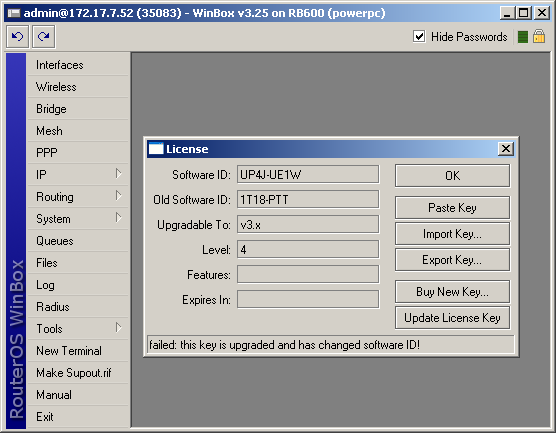

Hi!
The strange thing was happened with RB600.
Running on v3.27 many years, once after reboot it showed me the countdown, as if it couldn’t have any license.
I don’t remember all the actions that I did, maybe I has tried to update license. Finally I imported the same license that it has (7-chars), theh, after reboot, it become running as normal, without a countown.
But it become upgradable up to v3.x only. I tried to upgrade/downgrade to v3.30, v3.20, v3.25, but I can’t upgrade to higher versions.
Please help me to fix it.
Thanks!
