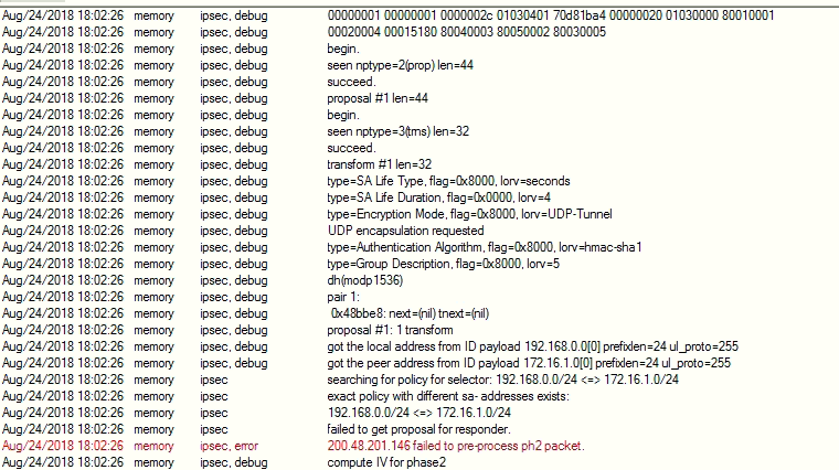

I’m doing an IPSec configuration on MikroTik with a Fortigate 100D, but it is showing me the following error. The MikroTik device is configured with Internet access.
The log tells you that an IPsec policy for exactly the same combination of local and remote subnet already exists in your configuration at the moment when the phase2 processing is trying to add it.
So either you have configured the necessary policy manually and in parallel the peer is set with generate-policy set to something else than no, or you have another running IPsec connection in place which has the same policy associated.
If these hints do not help, follow the instructions in my automatic signature, plus add the output of /ip ipsec policy print and /ip ipsec installed-sa print while the peer representing the Fortigate is active,
