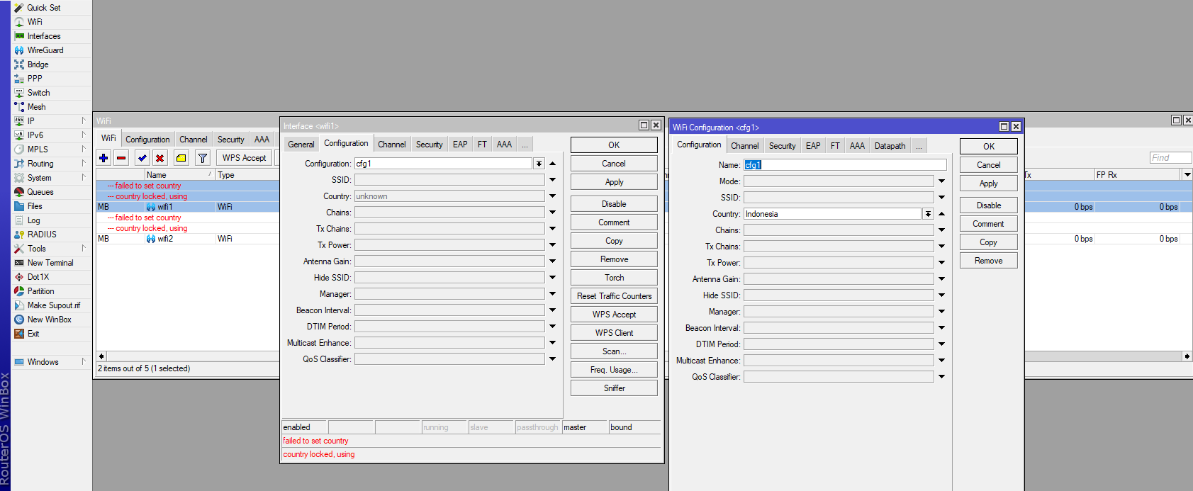

I have updated the RouterOS and the wifi-qcom-ac package to version 7.13.4 on my CAP XL AC device. However, the wifi interface shows “failed to set country” if either wifi1 or wifi2 is enabled.

Here is the device that I am using
Model : RBcAPGi-5acD2nD

This is a temporary configuration to test changing the country.
2024-02-13 20:19:10 by RouterOS 7.13.4
software id = VD4C-0QUI
model = RBcAPGi-5acD2nD
serial number = HDK08X49TYK
add admin-mac=48:A9:8A:24:78:08 auto-mac=no comment=defconf name=bridgeLocal
port-cost-mode=short
/interface wifi configuration
add country=Indonesia disabled=no name=cfg1
/interface wifi
country locked, using
set [ find default-name=wifi1 ] configuration=cfg1 configuration.mode=ap
disabled=no
set [ find default-name=wifi2 ] configuration=cfg1 configuration.mode=ap
disabled=no

As it says on the screenshot: your device is country locked !!

As additional information, before the upgrade, the country option was only Indonesia4. After the upgrade, the configuration without a template in the country selection only shows the option “unknown.”

I have inquired with the device distributor, and according to the information from the vendor, the device sold is locked to the country code “indonesia4” due to telecommunications regulations in Indonesia. ROS 7.11 supports “indonesia4,” but it is not yet available in the WiFi tab. Meanwhile, ROS 7.13 only has “indonesia” listed.
