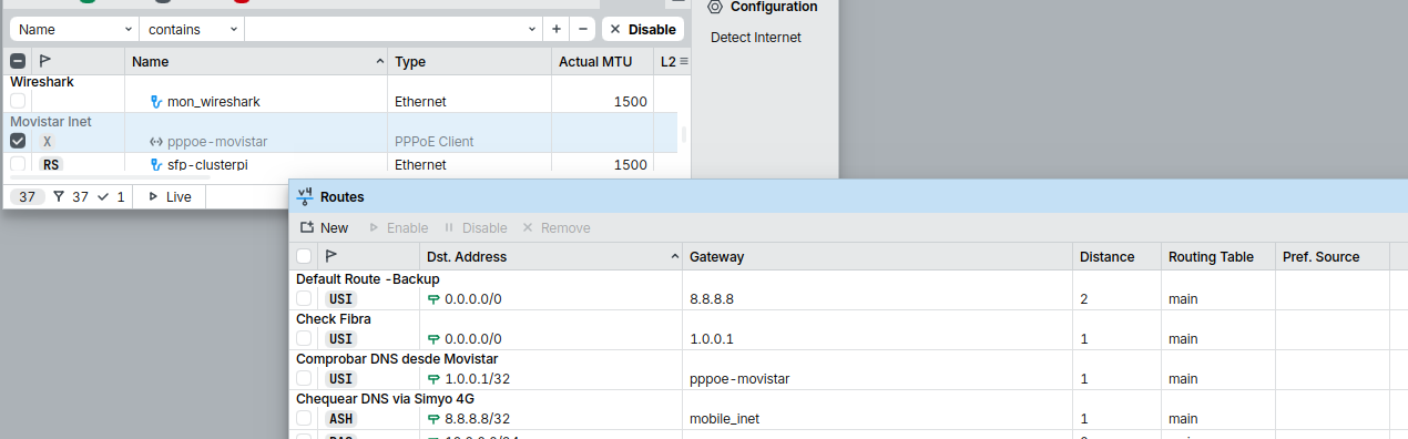

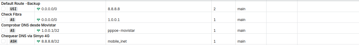

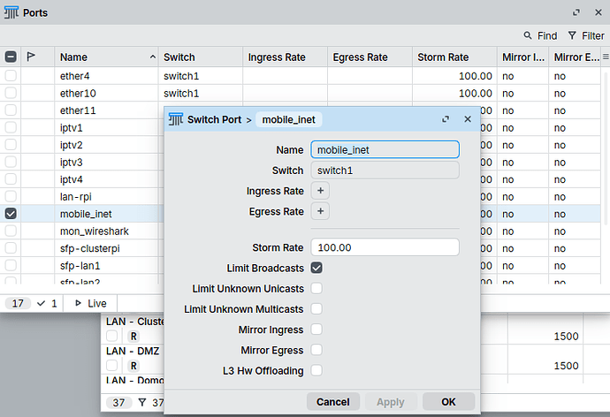

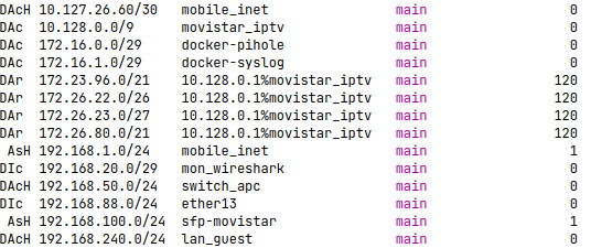

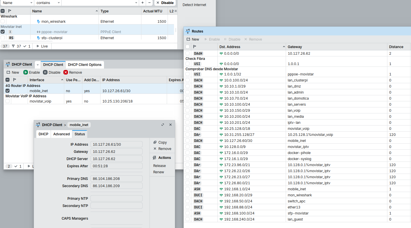

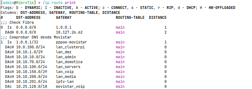

I have a problem that I am unable to solve. I have two internet connections on a Mikrotik CCR2116.
  • The main connection is a GPON with fiber output and PPPoE.
  • The second connection is in failover mode against a Zyxel LTE3301plus router-modem that is configured in bridge mode, so the public IP of the provider (CGNAT) is obtained by the Mikrotik interface.

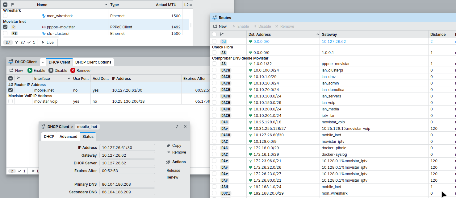

I followed the instructions on the following Mikrotik help page, but without success. If I follow these instructions, I never get a ping from the “mobile_inet” interface because, according to what I've read (I don't know if it's true), when you use an Ethernet interface in bridge mode in Mikrotik and it's not PPPoE, it's not able to know what its nexthop is.
As recommended in the DHCP Client of “mobile_inet,” I marked the one that added the default route and set the distance to 2. This is what I did, and I have only managed to get the 4G interface to work properly when the PPPoE goes down, and I can also ping out from the router through the “mobile_inet” interface. The problem is that from the local network I am unable to access the internet via the 4G connection. I have masquerading for that connection and the “traceroute” dies at the Mikrotik.

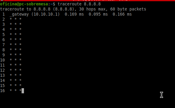

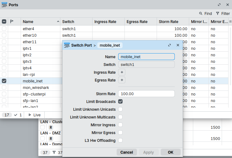

I tried using Torch to see the traffic coming to the “mobile_inet” interface, but nothing is coming through, as if the masquerading is not working for some reason.
Could someone shed some light on this for me? Here is my configuration:

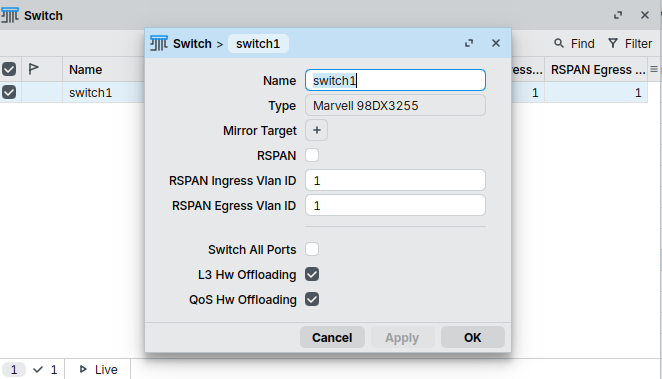

/interface ethernet switch
set 0 l3-hw-offloading=yes qos-hw-offloading=yes

I am not sure to understand what is the desired/expected working.
A dual wan failover setup means - normally - that the second WAN is never used until the first one fails.
Anyway, post the output of:
/ip route print
I think you misunderstood me. Of course, I know that in Failover mode, one works and the other doesn't, and that the secondary connection kicks in when the primary one fails, which is what I'm doing by manually disabling the PPPoE interface.
What I'm saying is that if I disable the pppoe interface, the 4G route doesn't come up because it can't ping through the interface since, as I've read, you can't add an interface to the gateway of a route that isn't pppoe or another one that I can't remember because it can't resolve the nexthop.
Here are the routes
If I disable PPPoe:
As a side note, you are using recursive on both routes.
You don't need (nor normally want) to use recursive on the last failover (the 2nd in your case).
The idea is that:
  1. if Wan1 works -> use Wan1
  2. If Wan1 doesn't work -> use Wan2
The check is only on Wan1 as - if Wan1 doesn't work:
2.1) if Wan2 works -> you have internet
2.2) if Wan2 doesn't work ->you don't have internet
there is no alternative (a third WAN), so there is nothing that can change if the recursive on 2nd Wan marks the route as unreachable.
I asked for the output of /ip route print because I am more familiar with the tags of that output, screnshots may be equivalent but they are more difficult for me to parse.
The issue is likely in the "gateway=mobile_inet" setting.
The gateway should be the IP address of "next hop".
Normally, with the Zyxel set as router, it would be the Zyxel router lan side address, with it configured in bridge mode you should set it to the gateway the ISP provides.
That should happen though the DHCP client, since you have chosen to use "add-default-route=no" and use manual routes, you need a DHCP client script, like:
to update the gateway to the IP provided by the ISP.
Or - since as said you don't really need to check recursively WAN2 - you could let the default route be created by the DHCP client, forcing the distance to 2.
I did what you told me to do. I set it to automatically use the default route with distance=2, and now I have ping from the router but not from the local network.
Now, if I stop the PPPoE interface, the default 4G route is activated, but I don't have ping from the computer.
And here is the traceroute.
/ip route print
Flags: D - DYNAMIC; I - INACTIVE, A - ACTIVE; c - CONNECT, s - STATIC, r - RIP, d - DHCP; H - HW-OFFLOADED
Columns: DST-ADDRESS, GATEWAY, ROUTING-TABLE, DISTANCE
#      DST-ADDRESS       GATEWAY                    ROUTING-TABLE  DISTANCE
;;; Check Fibra
0  Is  0.0.0.0/0         1.0.0.1                    main                  1
  DAdH 0.0.0.0/0         10.127.26.62               main                  2
;;; Comprobar DNS desde Movistar
1  Is  1.0.0.1/32        pppoe-movistar             main                  1
  DAcH 10.0.100.0/24     lan_clusterpi              main                  0
  DAcH 10.10.1.0/29      lan_dmz                    main                  0
  DAcH 10.10.10.0/24     lan_admin                  main                  0
  DAcH 10.10.70.0/24     lan_domotica               main                  0
  DAcH 10.10.100.0/24    lan_servers                main                  0
  DAcH 10.10.150.0/29    lan_voip                   main                  0
  DAcH 10.10.200.0/24    lan_media                  main                  0
  DAcH 10.10.201.0/24    iptv-lan                   main                  0
The routes overall seem fine to me.
Maybe now you are having issues in either /ip firewall filter or /ip firewall nat.
When pinging fails are you having timeout , host unreachable or no route to host?
What happens attempting to ping the gateway (10.127.26.62)?
This should work the same no matter if WAN1 is enabled or not, but you should have in the /ip route print (like you have on the scrrenshot) a DACH route for 10.127.26.62/30 on interface mobile_inet.
Yes, I have it. That's why I find it strange that I can't access the internet. I've pinged the gateway and can't reach it, but as you can see in the configuration, I have masquerade for the mobile_inet interface.
Hello everyone,
It works now!!!!! For those of you who have a similar problem, here's the solution:
The problem occurs when L3 HW OFFLOAD is enabled. By default, all ports are selected, so what happens if it is enabled? Since one of the Ethernet ports included is the one that provides access to the 4G router, it uses the Marvell switch chip instead of the CPU, so from what I've read, it bypasses the NAT rules and therefore the masquerade. I disabled L3 HW Offloading on the 4G port and it started working perfectly.
What needs to be disabled:
