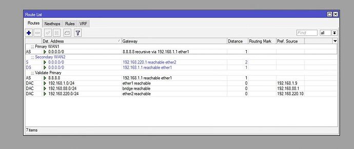

My failover doesn't work, or rather it works partially
Here is my configuration
WAN 1 - 192.168.1.X/24
WAN 2 - 192.168.220.X/24
LAN - 192.168.88.X
On WAN 1 I have an ADSL modem
On Wan 2 I have a 4g modem
These are the set routes
DST-ADDRESS PREF-SRC GATEWAY DISTANCE
0 AS ;;; Primary WAN1
0.0.0.0/0 8.8.8.8 1
1 SD 0.0.0.0/0 192.168.1.1 1
2S ;;; Secondary WAN2
0.0.0.0/0 192.168.220.1 2
3 AS ;;; Validate Primary
8.8.8.8/32 192.168.1.1 1
4 ADCs 192.168.1.0/24 192.168.1.9 ether1 0
5 ADC 192.168.88.0/24 192.168.88.1 bridge 0
6 ADCs 192.168.220.0/24 192.168.220.10 ether2 0
The problem is as follows
If I unplug the WAN 1 cable on the mikrotik manually then it automatically switches to WAN 2
If instead I disconnect the ADSL cable on the modem of wan 1 the switch does not work
Where am I wrong?
