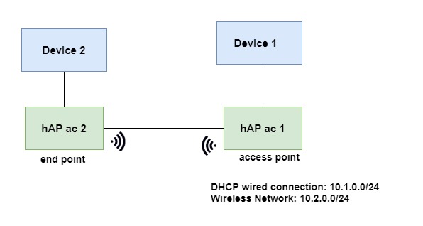

Hi there,
I want to design a simple network using two hAP ac switches as shown in the diagram. Both hAP ac will be connected to each other through a wired and wireless network. Whenever one network is unavailable (wired or wireless), I want all devices to automatically switch to the other network and communicate. If someone can provide a quick on this it would be very useful.

There is no internet requirement at this stage. What I want is for two devices(device 1 and device 2) to be able to communicate with each other constantly as shown in the diagram. If one of the links (wired or wireless) goes down for any reason, the other link will automatically start communication and provide connectivity.
Dont understand, are you expecting the cable between the two devices to fail… lot of rodents in the walls?
Multiple ways to do this, either layer 3 (routes) or layer 2 (interface bonding).
L2 Like the CUBE 60 doing bonding between the 2 wireless links (60GHz and 5 GHz)

A Similar thing could be setup in your case with etherX and wlanY as slave interfaces.
Only bond1 is used as interface to the bridge, not the slaves. “ether1” stands above for the other ethernet interfaces, also on the bridge for a L2 bridged network.
For monitoring options see: https://wiki.mikrotik.com/wiki/Manual:Interface/Bonding
