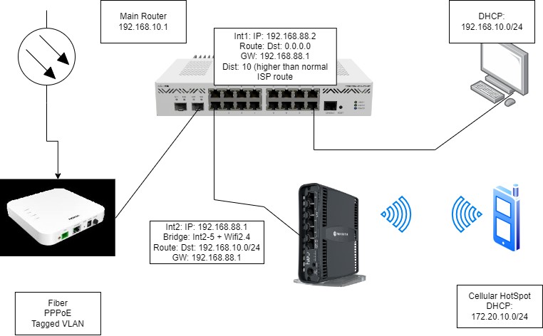

So my main router is the CCR2004-16G-2S+PC and is working great. I also have a good data plan on my cellphone and i would like to set up a failover WAN connection that runs from my cellphone hotspot to a hAP ax2; the setup would look like this;

After some time i finally was able to spend the time to figure this out - it is relatively simple once you understand the networking, Here is the main points of my config for the hAP ax2

The basic setup is setting the LAN ports (optionally add wifi_2.4 ) as a bridge, define a static IP of 192.168.88.1 on an interface (int2 in my case) , set the 5Ghz in station mode, and then join the AP of your secondary WAN. Once connected you can confirm that you have internet access through that connection. Then set a static route back to your main router LAN IP range using the interface IP on the hAP, again my case it is 192.168.88.1
Next on the main router i configured a static IP of 192.168.88.2 on int1(eth1), connect int1 (main router) to int2 on hAP and verify that you can ping both sides of the connection. Finally add an second internet route in the main router with a higher distance out to the internet using the IP of the hAP (in my case 192.168.88.1).
I made the mistake of using the IP on the main router, 192.168.88.2, as the gateway but in reflection it is the source IP and not the gateway.
Here’s what the diagram looks like and i hope this helps anyone figure out this type of setup;
