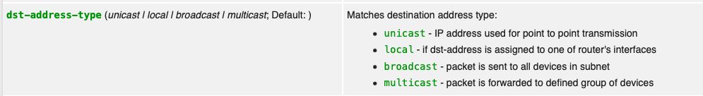

Now does adding these rules affect fast track at all ? (I almost think it doesnt because its only marking packets and not doing anything within the “established/related” state packets ..
Also would I need to be concerned about also excluding the more then just !local.. maybe broadcast and unicast.. I still will need things to communicate within the same broadcast domain..(which I didnt think would be effected by the router anyways.. “layer2 doesnt need a router”).
Does the !local also avoid marking packets to the local devices or just what is destined to the router. ?
