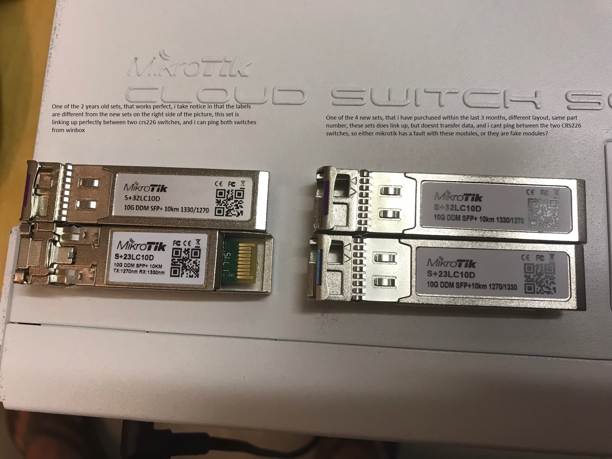

Hi all, I have a very strange problem
Have recently bought 4 sets of S+2332LC10D Wdm modules, from Inter Projekt Poland
I have used these modules in many years without problems, and have currently 20 x 10GB Links running with these module sets
But the last 4 sets that I have bought, doesn’t work, when connected between to CRS226 Switche, winbox says link OK, but I can’t ping the devices from within Winbox , if I change the modules to s+31DLC10D the switches works fine.
I have been trying to figure out over the last couple of days, why these 4 new sets doesn’t work, and if I look at one of my old sets of WDM modules with the same part number, I can see that there is a difference in appearance , even though its the same part number.
I can see that the old modules are different than the new modules, and im wondering if they are fake modules, or if you have changed something in the modules, since the new ones I buy doesn’t link up properly.
Im attaching pictures of the new and old module?
