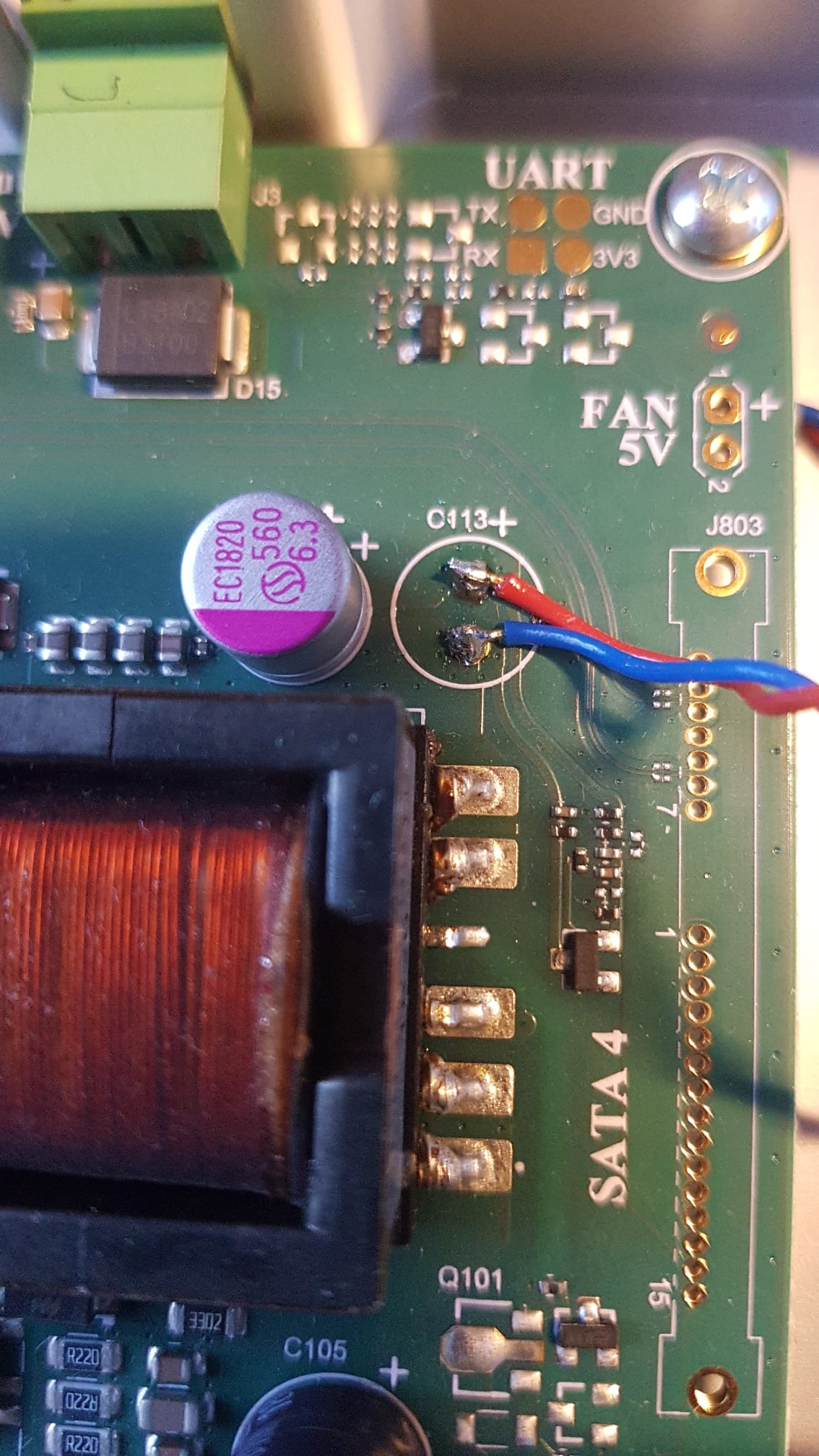

when you have it open anyway, make a hi-res photo of that area of the board and put it here…
Here are the pictures:
Full board:
Power section detail:
now, after several tests, I would suggest not to tap one of the DC input PSU’s connectors (the white ones). Even though it supplies 24VDC with more than enough current to power bith the board and the fan, these 2 inputs are isolated against each other, meaning that if you have conected your fan to input one and it fails, then your fan will stop working even if PSU2 is still supplying the board.
I found 2 viable options where you can connect a fan:
  1. next to the DC input 2 connector, below the C105 cap you have 2 tap points (just above the D100 diode). These taps provide 24VDC no matter if PSU1 or PSU2 is powering the board. (+ is on the connector side, so on the right). Careful however: if you power your board throuch PoE, you will see +48V on those pins!! So basically, these pins have the voltage of the highest voltage of any of the board’s active power supplies. So you should use this solution ONLY if you power your board via the built-in power supplies OR PoE OR Telco 48V. BE CAREFUL!!
  2. probably the best solution (but I didn’t test it yet because I don’t have such fans at hand) is to tap of the voltage on the pads C113 next on the top right cornet of the transformer. These pins have a 5VDC output no matter what the board’s supply is. this is the main 5V voltage bus of the board, which is filtered via the gray/pink cap just next to it, and also re-regulated to various specific voltages on many other places on the board. Be careful however, I would aim for a 5V fan with the smallest wattage, just to be on the safe side and avoid any possible disturbances.
I have ordered a couple of 5V 30mm x 30mm x 10mm fans (6mm thick fans would be even better) and will report when I have it working…
Disclaimer: If you damage your board, hurt yourself or kill your dog, it’s your fault, not mine! If you open up the enclosure, you agree to take full responsibility for anything that might happen including injury, death, or even a pink dinosaur knocking down your front door and eating your family. Remember that if Mikrotik sells the device without fans, it means that it doesn’t need any fan! And these boards are installed all around the world and seem to be running fine without any fan!
OK I found a fan in my garbage. Sunon MF30060V21000UA99 (30x30x6mm)
Works like a charm. For the moment the fan is blowing the hot air out of the case but it might be better the other way around. I will monitor it to see which way is better.
Enjoy!
Thanks for the pictures… did you check the 2 locations for transistors (or double diodes) near the 5V FAN connection?
Do they have 5V on some of the pins?
They could be related to the FAN pins, and the fact that they are not populated could explain why there is no output voltage on that connector.
For example, I have some older CCR1009 in use and they have 2 FANs, in the config one can select a primary and secondary fan, one is running and the other is started when the first one fails, and they are regulated towards 50 C temperature of the processor.
It could be that this unpopulated space was for a similar circuit with one fan (only temperature control)…
These missing transistors look like a simple voltage supply regulation with no negative feedback so that the fan does not cause any interference with nearby circuitry. But it could also be for a LM7805 voltage regulator IC (also 3 pins)…That would require some advanced reverse engineering. Therefore I did not check that as I wanted a simple and easy solution, and wanted to avoid the potential necessity for soldering SMD components. Moreover, taping 5V for the fan there could have an impact on the UART outputs. It could be that some resistors in this area would need to be replaced with other values. This is clearly not worth the trouble. Having the fan connected to the main 5V bus near the noisy power section is easy, quite fool proof and good idea since the power is cleaned and regulated on subsequent stages anyway.
One thing is for sure: there is no proper fan control or monitoring, as there are only 2 fan pins. The monitoring could never see if the fan stopped working like in the CCCR1009 (I guess there are at least 3 cables to the fan)
However if cou could also post come pictures of CCR1009 boards, we could have a look if the circuit looks similar. Do you have the possibility to identify and measure the values of semiconductors?
