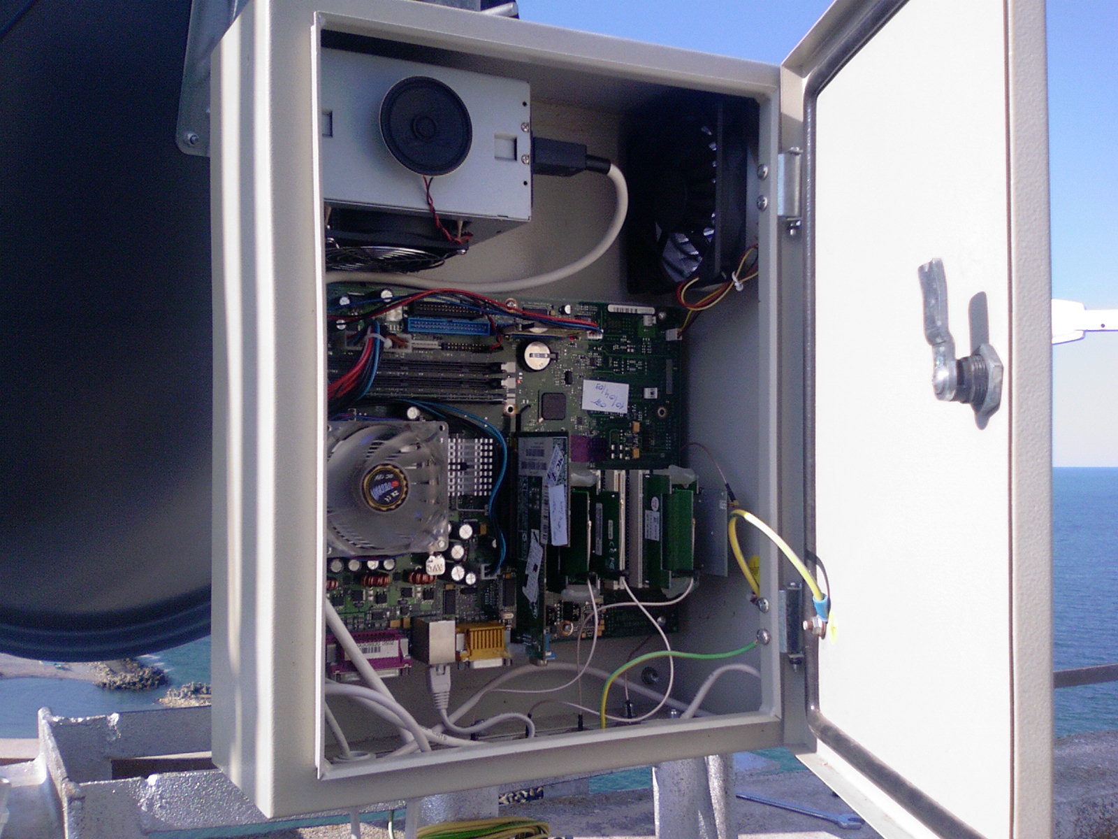

mine R5H is cold…use ventilated or metal box
I have used that brand of metal box that Inox uses. They are made in Malaysia by CVS so they should be nice and cheap for you!!!
See http://www.cvsenclosure.com/

inoX - that’s a daddy mate but aren’t you using too long Rf cables? - obviously I can’t see the rest.
regards.
Steven
2-3m pigtails…no problem.
