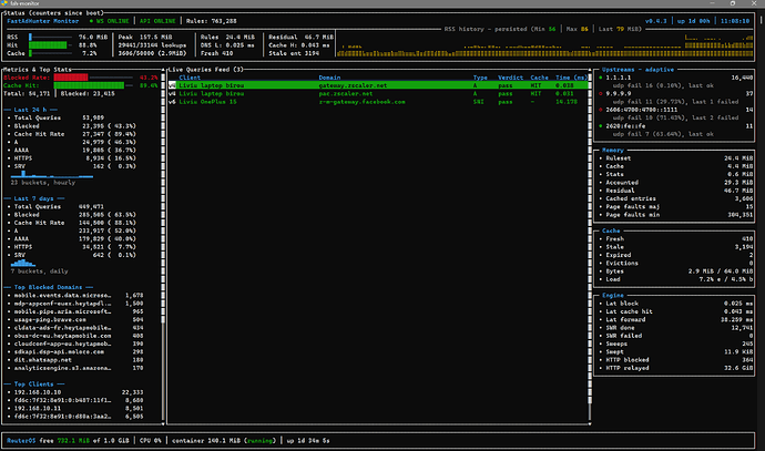

Running in production on a MikroTik RB5009 as the household's only resolver, in dns+http mode. Phase 2's engine work is deployed — the transparent HTTP proxy, URL-path rules, per-client Policies and the single JSON telemetry surface. What remains open is a memory-transient investigation, not a feature.

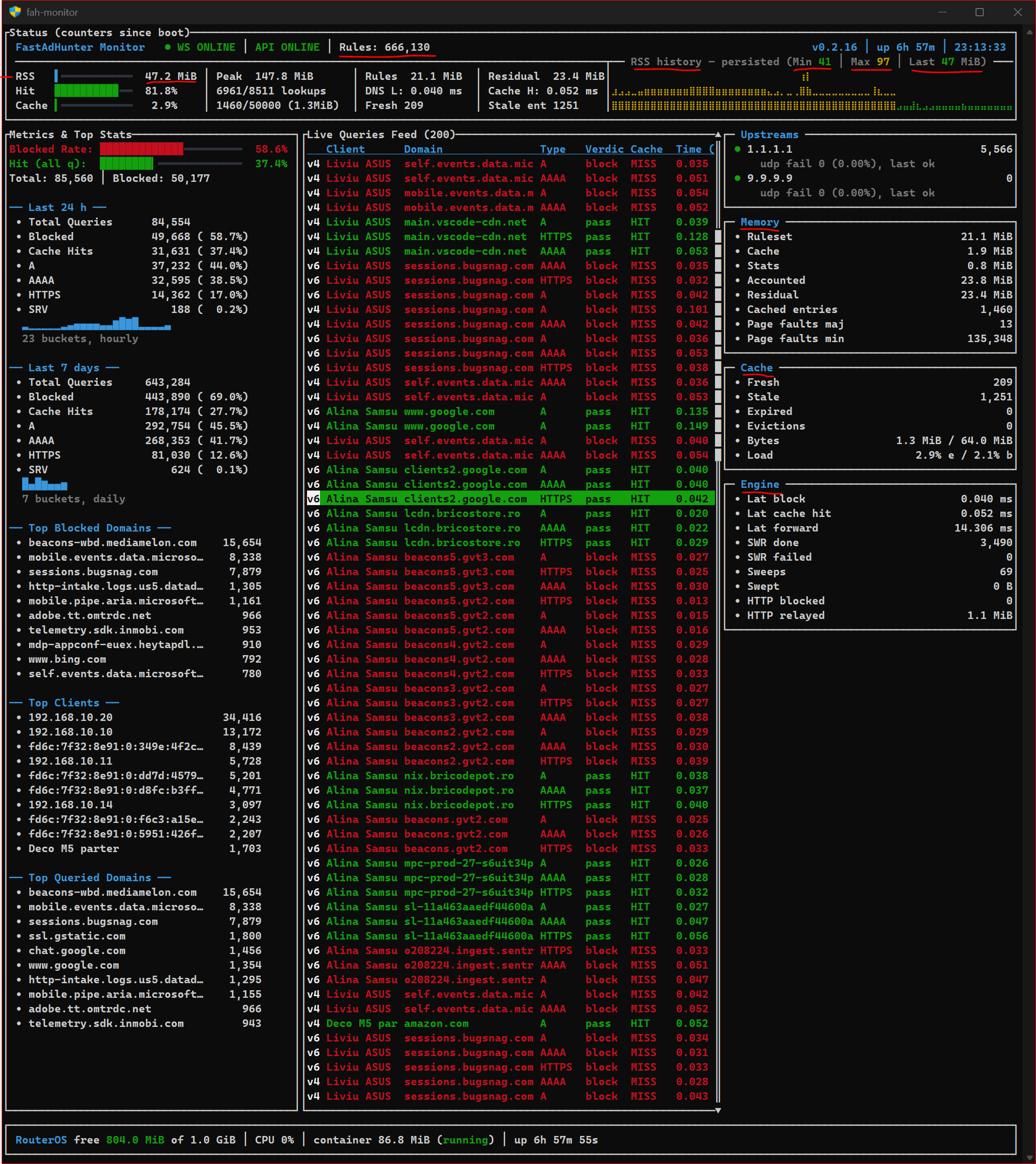

Measured, on the RB5009
Quad-core ARMv8 @ 1.4 GHz, 1 GB RAM shared with RouterOS. Every figure comes off the deployed container, not a dev box. Measurements are binary (MiB); PERFORMANCE.md writes its budgets in decimal MB, which runs ~4.9 % higher for the same reading.
Measured Budget
Resident memory, 666130 rules + 50 k-entry cache 47.6 MiB ≤ 128 MB
Peak RSS at boot 117.8 MiB ≤ 128 MB
Peak RSS during a list refresh 171.7 MiB see below
Ruleset compile, 1.15 M parsed rules 2.85 s < 3 s
Ruleset heap, resident 25.8 MiB ≤ 40 MB
Blocked verdict, in-engine 0.045 ms mean < 1 ms p99
Cache hit, fresh + stale-while-refresh 0.227 ms mean < 1 ms p99
HTTP proxy, added latency +161 µs min · +344 µs p50 < 1 ms
HTTP proxy, opaque throughput 271 / 208 MiB/s ≥ 100 MiB/s
URL verdict, 8 KiB URL, full EasyList+EasyPrivacy 554 µs < 1 ms
Sustained DNS throughput, deployed path 20 k+ QPS :grinning_face: ≥ 10 k QPS
Container image 13.0 MiB ≤ 30 MB
Dropped events under real load 0 0
Rule lists compile 1 148 024 parsed rules into 666130 after deduplication — 349 264 duplicates, 30 % of the input across 16 public lists. Deduplication is paid once at compile time and keeps the matcher smaller for the life of the process. It also shortens probe chains: a domain carried by two lists occupies one slot instead of two that hash to the same place, worth 46 % on lookups for shared domains.
The 20 k+ QPS figure is /tool profile on the live box under a synthetic hammer, with all four cores sharing evenly — reception is not the bottleneck, so SO_REUSEPORT stays a documented recipe rather than shipped code.

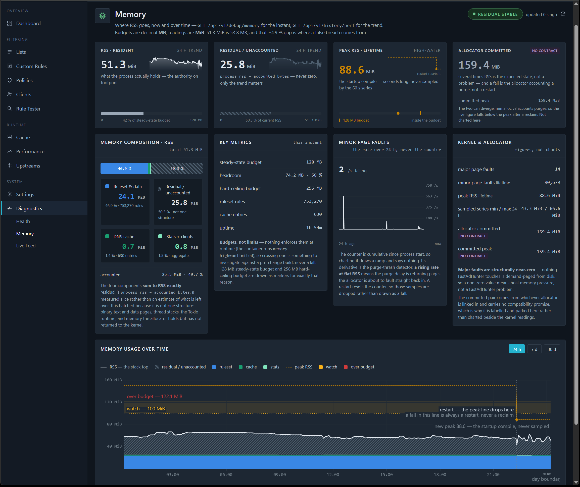

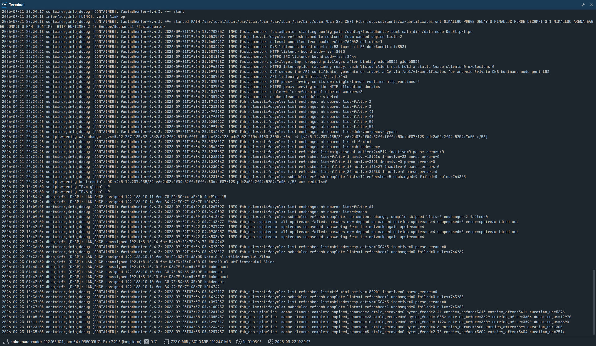

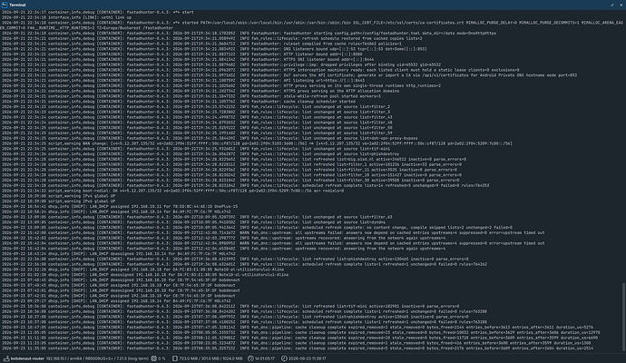

The refresh transient is the one figure above its budget. Recompiling the ruleset briefly holds the outgoing matcher, the freshly fetched list bodies and the new arena at the same time, peaking around 172 MiB before falling back to ~47~50 MiB. It is bounded and it does not ratchet — steady RSS returning after every refresh is the evidence — but it is real, and reducing it is the one Phase 2 task still open. Structural accounting: p2-12.

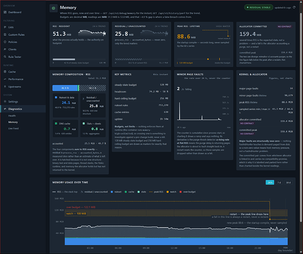

Memory is otherwise bounded, not merely small, and the instrument that proves it runs continuously: RSS − Σ(components) = residual is exported on every sample, so a leak shows as the residual growing while the named components stay flat — the growth you legitimately expect has already been subtracted out. Across two independent on-device windows of 61.3 h and 36.2 h (4 657 samples), the residual slopes are +0.082 and +0.027 MiB/h, with the sign disagreeing between the windows' final thirds: drift indistinguishable from noise.
RouterOS reports the container larger than the process is. memory-current sits around 85 MiB against a ~47 MiB resident set; the difference is cgroup page cache — reclaimable file-backed pages from the image layers and the cached rule lists — not consumption. The figure that matters is the process's own resident set.

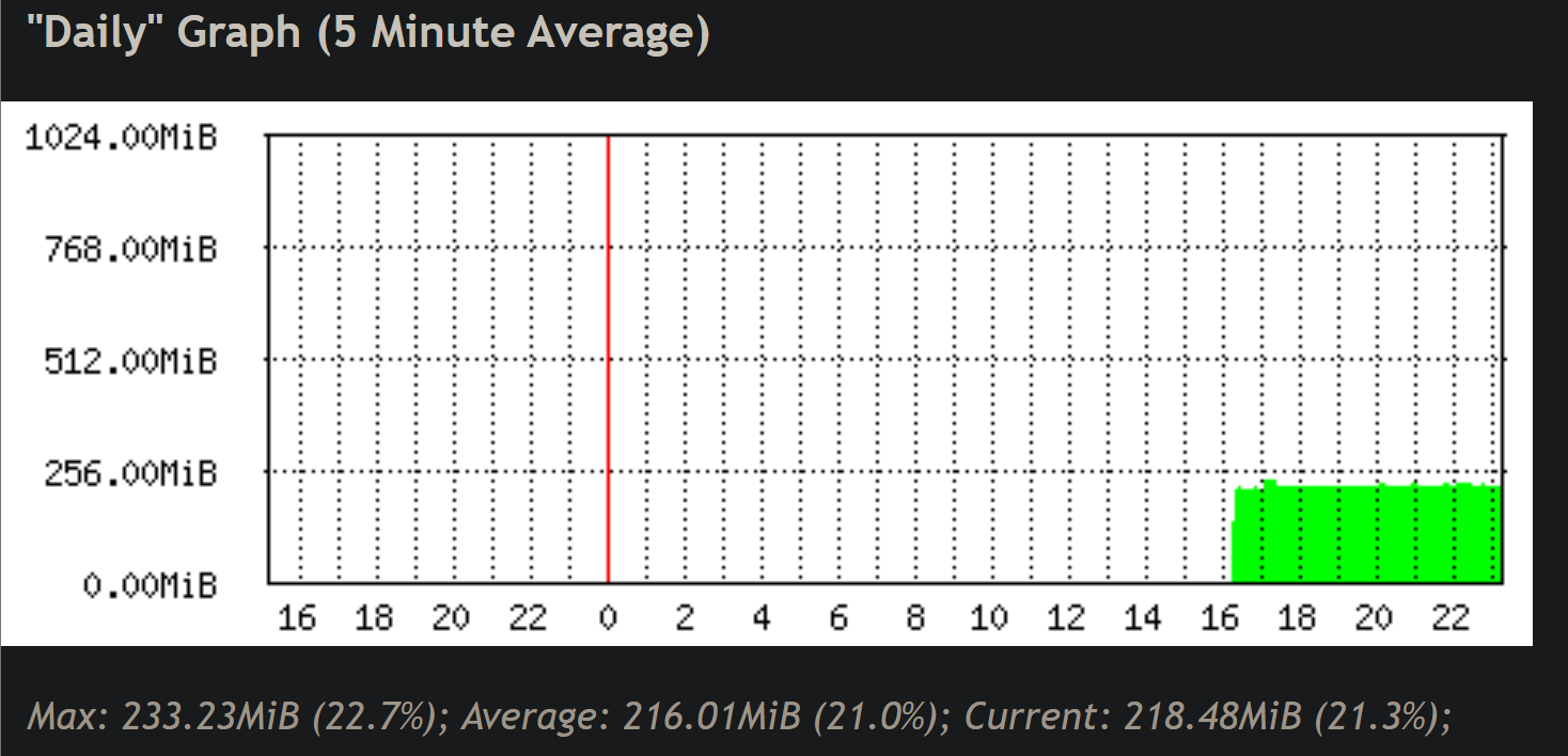

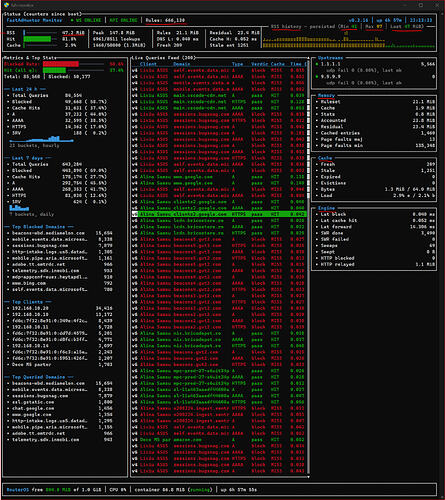

RouterOS Usage Graphing (only 7h because I've deployed a new version):

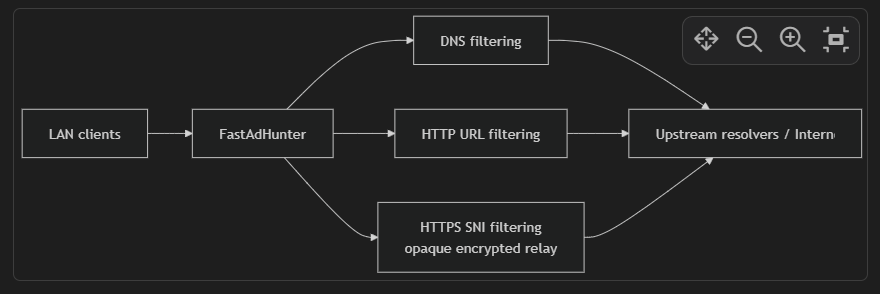

Work is distributed across Tokio workers; the architecture avoids centralised processing. One task per datagram, one shared compiled ruleset behind an atomic swap, and no lock on the path that answers a query.

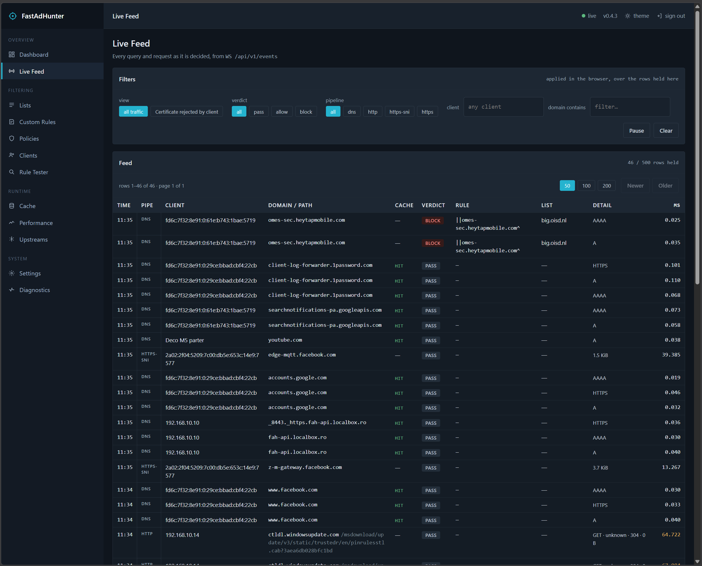

GET   /api/v1/telemetry             whole engine state as JSON: counters,
                                    latency stages, upstreams, cache, memory

GET   /api/v1/debug/memory          per-component heap + residual
WS    /api/v1/events                live query stream
