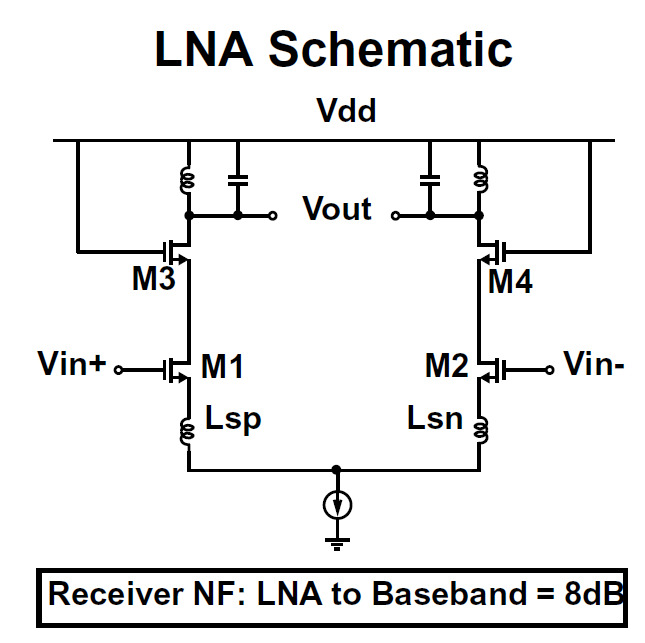

If the front end of LNA is “Wideband” and picks up a lot of channels, then would it not follow that if these other channels where being received had high signal strength it could overload of the radio card,

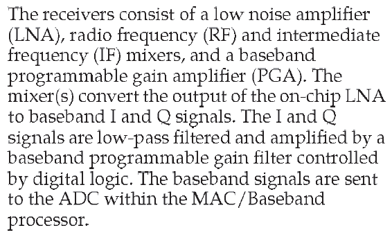

Also i read with interest … Low noise amp, RF, IF mixers, baseband programmable gain amplifier (PGA)…The I and Q signals are low-passed filtered and amplified by a programmable gain filtered controlled digital logic… no mention there of bandpass filter just low pass for I and Q and no mention of the specification of the gain filtered logic?
All of this would indicate to me that current radio cards are not designed for use by WISP’s but for domestic usage and when manufacturers design a radio card especially for WISP’s which has say TX=20Mhz and RX=20Mhz or TX=40Mhz and RX=40Mhz, etc. then maximum speed could be achieved by wireless protocol’s which NV2 is just one?
