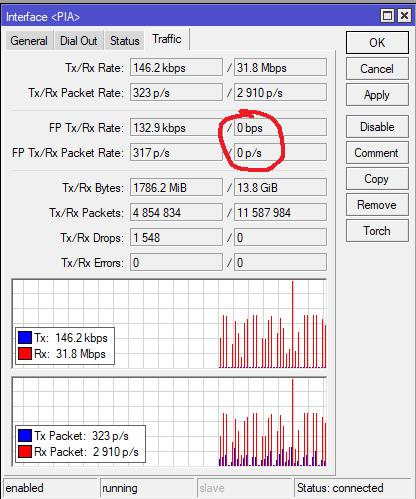

Fastpath on L2TP client only working for RX
I’m using a PIA VPN L2TP connection without ipsec, I’ve enabled NAT (masquerade), fasttrack & accept filter rules & no other settings that might affect Fastpath.
Why is my L2tp client connection only doing Fastpath on TX packets? Am I missing something?
I’ve also messed with lowering MSS to avoid fragmentation, but that’s not the issue here.

does anyone have a clue?
@icsterm Have you solved your problem? I have the same issue
I stopped using L2TP all together.
I don't remember finding a fix for fastpath over L2TP.
