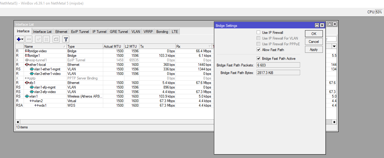

Hi, just want to resurrect this thread. Can anyone confirm that fastpath is working with VLANs? I have plain wireless bridge which moves traffic to a software VLAN interface as on the picture. However, Fastpath doesn’t pick up my multicast stream from WDS interface.
At the same time unicast traffic arriving at the parent wlan1 interface (which is bridged to another VLAN) is being passed through ‘fast-path’ quite fine.
Could virtual interface be the problem here or fastpath doesn’t support multicast?
