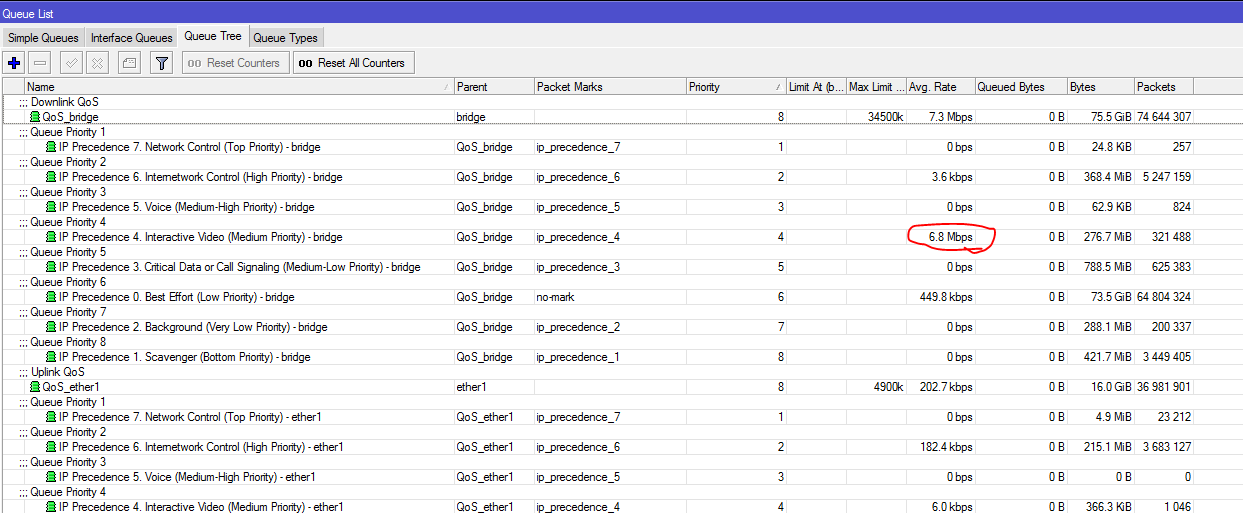

In case it helps, I can show you a similar rule I have for NetFlix prioritization (though I do it slightly differently)
I find that NetFlix always sends data to me from a certain IP so I match that IP (185.101.97.195).
In my firewall filter rules I have:
30 ;;; bypass fasttrack for netflix
chain=forward action=accept connection-state=established,related connection-mark=netflix log=no log-prefix=“”
Then, in my mangle rules:
17 ;;; Prioritize Netflix
chain=forward action=mark-connection new-connection-mark=netflix passthrough=yes src-address=185.101.97.195 log=no log-prefix=“”
18 chain=forward action=change-dscp new-dscp=32 passthrough=yes connection-mark=netflix log=no log-prefix=“”
19 ;;; Respect DSCP tagging
chain=postrouting action=set-priority new-priority=from-dscp-high-3-bits passthrough=yes
Mangle rule 19 above is already included with my script, I just included it so that you could see the relative positioning of my prioritization rules.
I mark the DSCP tags instead of directly marking the precedence so that I can use this tag on additional internal routers if I had them, but I could just as easily mark packet as ip_precedence_4 with the mangle rule listed as 18, then I wouldn’t really need the passthrough=yes on that setting (that approach is closer to what you are doing).

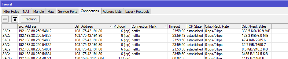

Also, look in the “Connections” tab of IP->Firewall to make sure the connection in question is getting marked properly. You should see it in there with the connection mark you are applying.
As you can see, it works for me and makes certain that I can browse the web on my PC without interfering with NetFlix viewing:

Oh, BTW I missed one rule change from my screenshots - the NetFlix address changed, so I had to change the mangle rule:
chain=forward action=mark-connection new-connection-mark=netflix passthrough=yes src-address=108.175.32.0/20 log=no log-prefix=“”
The old rule did not catch the 108.175.42.191 address
