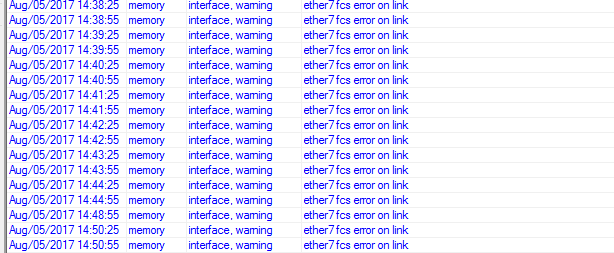

Hello Mikrotik forum,
Can someone to help me what this error as you can see on attachment mean?
I have Mikrotik Router CCR1009.
Thank you in advance.

Is there an AIrFiber on ether7?
Dear Pukkita,
Thank you for your comment.
It was physical problem. The Patch cable has been damaged and i change it.
That’s solve my problem.

Hi Pukkita,
I have same error and yes i have an airfiber on ether. do u know why like this ?
Check first the usual suspects: cable, injector…
If those are fine, AF’s are known to inject its own radio tx signal back into ether if there are obstacles in front or near it, causing these FCS problems.
Lower Tx power if possible and check; if these go away, that’s your problem.
Has any radio been deployed recently at the AF spot? Check for nearby obstacles…
