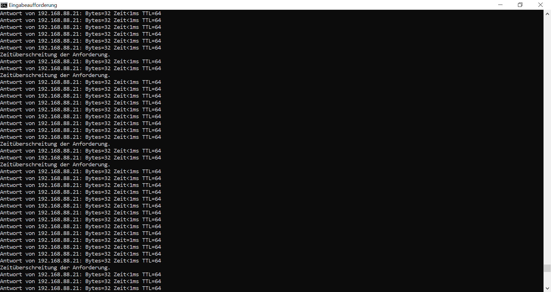

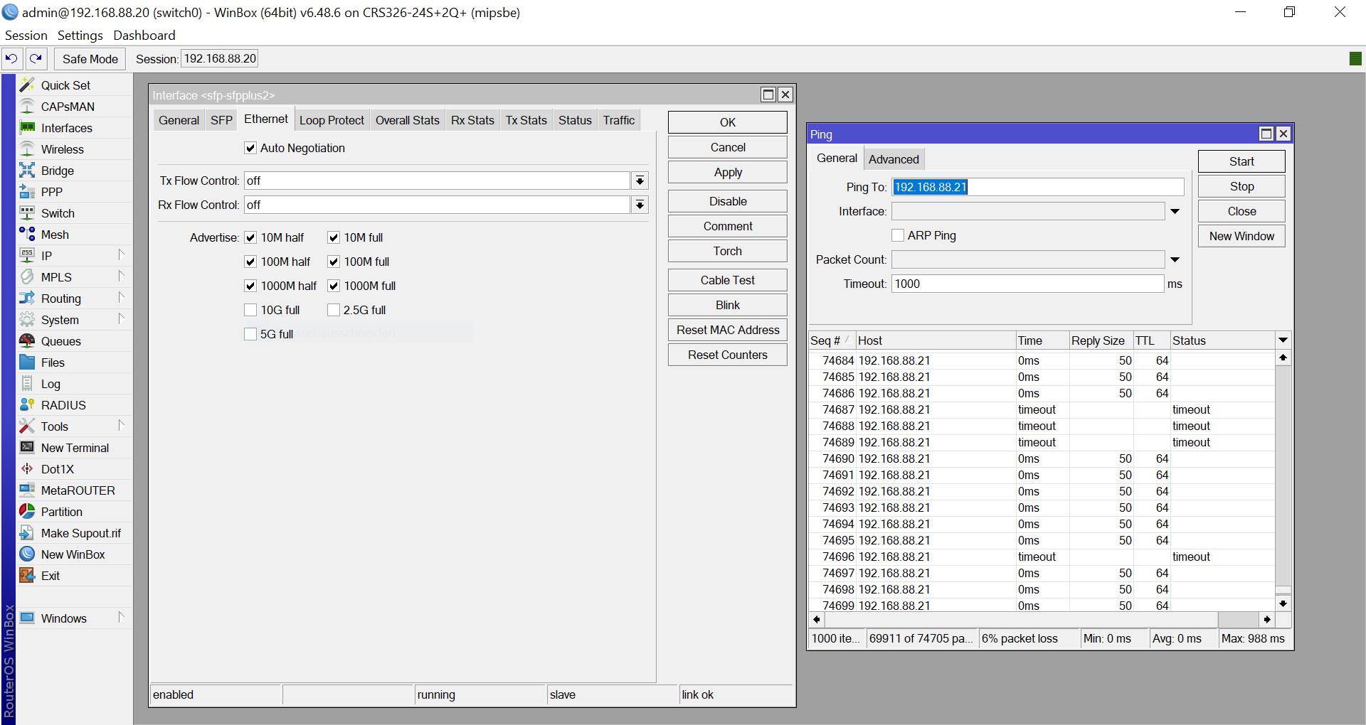

After a more or less short period of time, pings from switch0 to switch1 will timeout, then again be successful, then again timeout… so on (see .png attached).
config_switch1.rsc (758 Bytes)

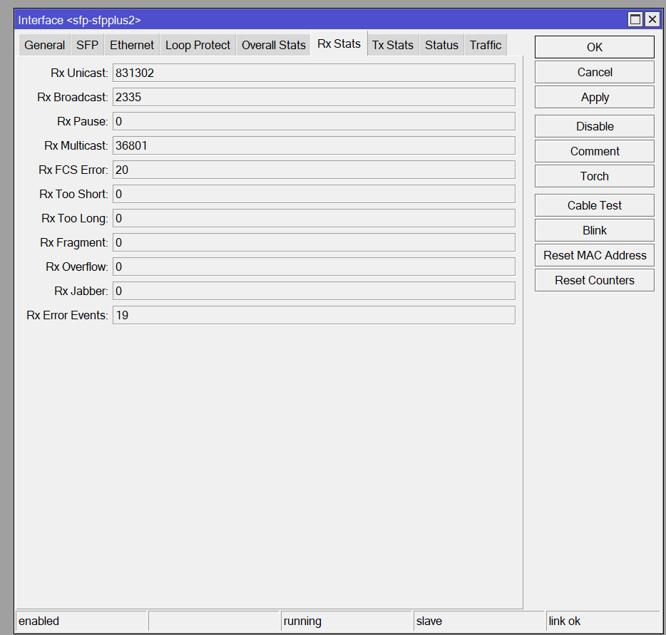

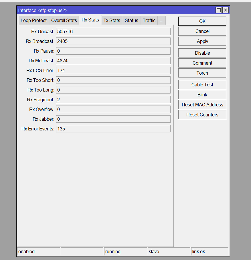

FCS errors rises by time on the involved interfaces. Link Down count also rises, so does Rx Error Event count (see .png attached).
We further connected a ThinkPad to sfp-sfpplus24 (with S-RJ01) on switch0 and pinged switch1, same outcome (see .png attached).
