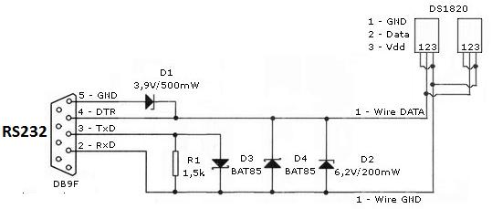

simple 1wire to RS232 adapter:
other sample:
http://www.hoppie.nl/tempsens/
This adapter is very cheap and small size, all elements are easy buy.
Cost < 2 euro.
This adapter can be add to RB411 and any other RB with RS232 / PC to monitor outdoor boxes.

according to the article:
The host machine needs a small circuit to convert the 1-Wire bus to something that can be connected to a standard RS232 connector, although > the protocol is not at all RS232> .
Just needs 4 diodes and 1 resistor.
You can talk with these devices through any rs232 interface.

This hack has nothing to do with RS232 nor even UART. 1-wire is not serial and this will not work on many RS232 controllers. Implementing this in a router would be really dumb if it doens’t work on most hardware. You can make it work using a simple Attiny with a proper UART<>1-wire conversion. This way MT or any other UART device can access them without a hack on the Linux RS232 driver.
