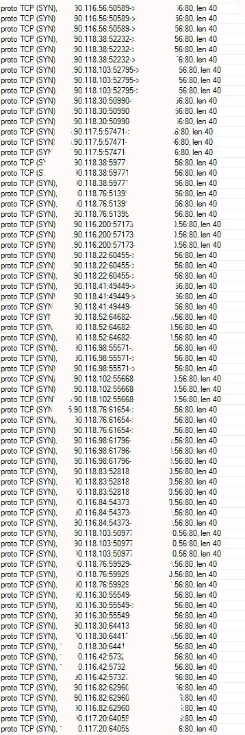

This is how that address distribution looks for real and here I have xx.xx.116.0/24 xx.xx.117.0/24 xx.xx.118.0/24
The attack is still going and it I am now at 62K requests in several hours.

I looked at the log and noticed that the packet have a small size of 40 and I just filter now on that size of between zero and 40, directed at port 80 and being a sync packet. This is a workaround and rather have the opportunity to recognize and block this kind of ‘grouped-hydra’ attack.
This workaround works better than the now available dst-limit because normal traffic does not suffer because of dropping those packet and the connection still works for that traffic.
