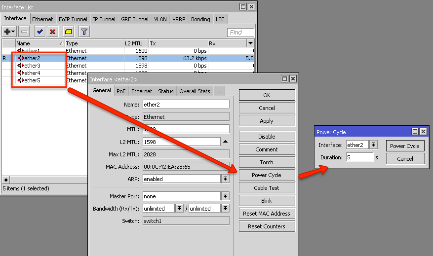

Power cycle is implemented in console in Winbox.
Here is the screenshot from Winbox.
Do you have any problems with it?
power-cycle command documentation:
(http://wiki.mikrotik.com/wiki/Manual:PoE-Out#Port_settings).
Port monitoring with ping and automatic power-cycle is implemented as
well in console. We will update the documentation.
