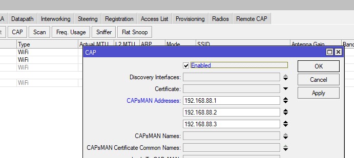

Not sure if it works, but there seems to be a way to make CAPsMAN redundant:
http://forum.mikrotik.com/t/how-to-make-a-capsman-redundant/131781/3
Just set up as many copies of capsman as you think you need. Specify their addresses CAPs points will try to connect through a list of addresses from top to bottom to the first available one.
