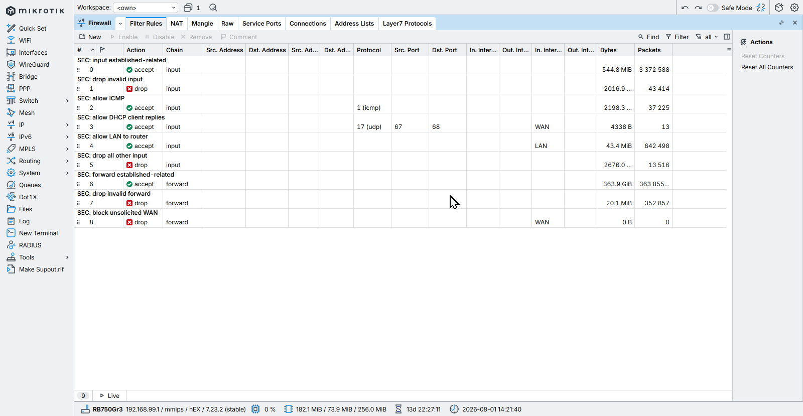

Whenever I configure the column view to only show columns with values, an OS update resets my layout and erases my settings. This is very frustrating.

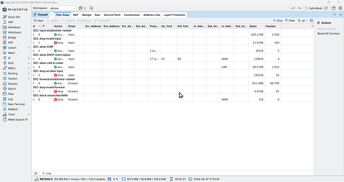

However, I notice that you are currently using the <own> workspace in WinBox. When that's the case, the layout customizations are stored per device's address (IP or MAC address or hostname). If you want the same persistent layout customizations across multiple devices, create a workspace with a name:
Make all layout customizations that you want, then you can switch to that workspace on-the-fly anytime you desire. Or you can preselect the workspace on the login screen.

After updating the OS from 7.23.2 to 7.23.3, my previously configured column layout became messed up again—it was reset to the default. The solution you provided earlier did not resolve the issue.
Hm, this is a particular case that I cannot reproduce. I've multiple devices that have been upgraded from 7.23.2 to 7.23.3 and no firewall table layout has been lost (not only firewall but I've seen no other table that have changed between those version). In fact, I am using the same workspace file right now and switching between devices running 7.23.3, 7.24rc3, 7.21.5, 7.22rc4 and all have the same layout and column widths.
The firewall table layouts (also for the IPv6 firewall) have not changed for me since many months (can't remember the last time I had to resize or show/hide a column).
