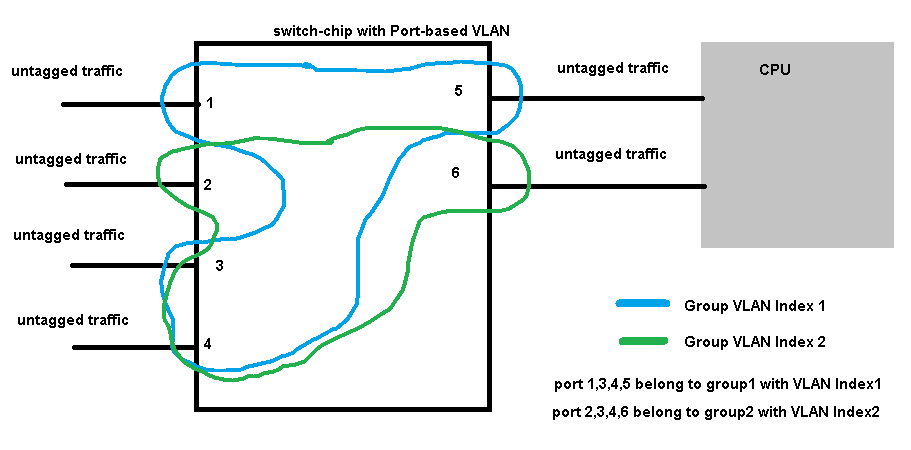

No, currently routers with switch-chip can only Tagged Vlan (802.1Q).
My suggestion about port-based Vlan.
It two absolutely different types of Vlan.

if you assure that currently switch-chip can, please show Winbox screenshots for this:

So packets incoming to port 3 or 4 should be assigned to… which VLAN? Because I’m afraid packet can be assigned only to 1 VLAN.
I think i see what you mean now by port-based VLANs and why you see it as something different from internal tagged vlans. I don’t know if it always works like this but in case you specified it can be converted to tag-compatible setup by introducing VLAN index 3 being sum of VLAN1 and VLAN2 (all ports assigned). Then packets incoming to port 3,4 are assigned to VLAN3 which makes them switchable to all ports like desired. I feel that complexity of such solution is going to grow exponentially with introducing more VLANs.
On the other hand i feel this design is terribly broken because it allows island jumping out of box. If machines in ports 3,4 get compromised your whole VLAN setup is gone so it’s significantly less realiable than non-overlapping VLANs. And remember it’s L2 so you have no firewall. You’re merging security domains on L2. It feels wrong and reckless by definition.
In fact I guess MTK switches don’t support it either.
https://community.hpe.com/t5/Switches-Hubs-Modems-Legacy/Overlapping-vlans/td-p/3652542
Here you can find some guy trying to do that on HP switch and it didn’t work as expected.
HP 2500 switches dont support full featured Port-based Vlan (cannot put one port to two group) and overlapping Vlans supports only with Tagged Vlan (802.1Q) mode.
