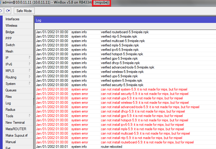

I’m pretty sure it says in the logs that it was the wrong package type. Did you check the logs after a botched upgrade?

it does report wrong package type. you have too many logs, like fewi said. the only time when the package stays there, and log is empty, if you put the files into a subfolder, where upgrader doesn’t see them.

I just tested, and you are not correct on this:
OK, I lie. It’s not that it happened to me two days ago. I just imagine.
Please do a test, and post full logs and file print.
