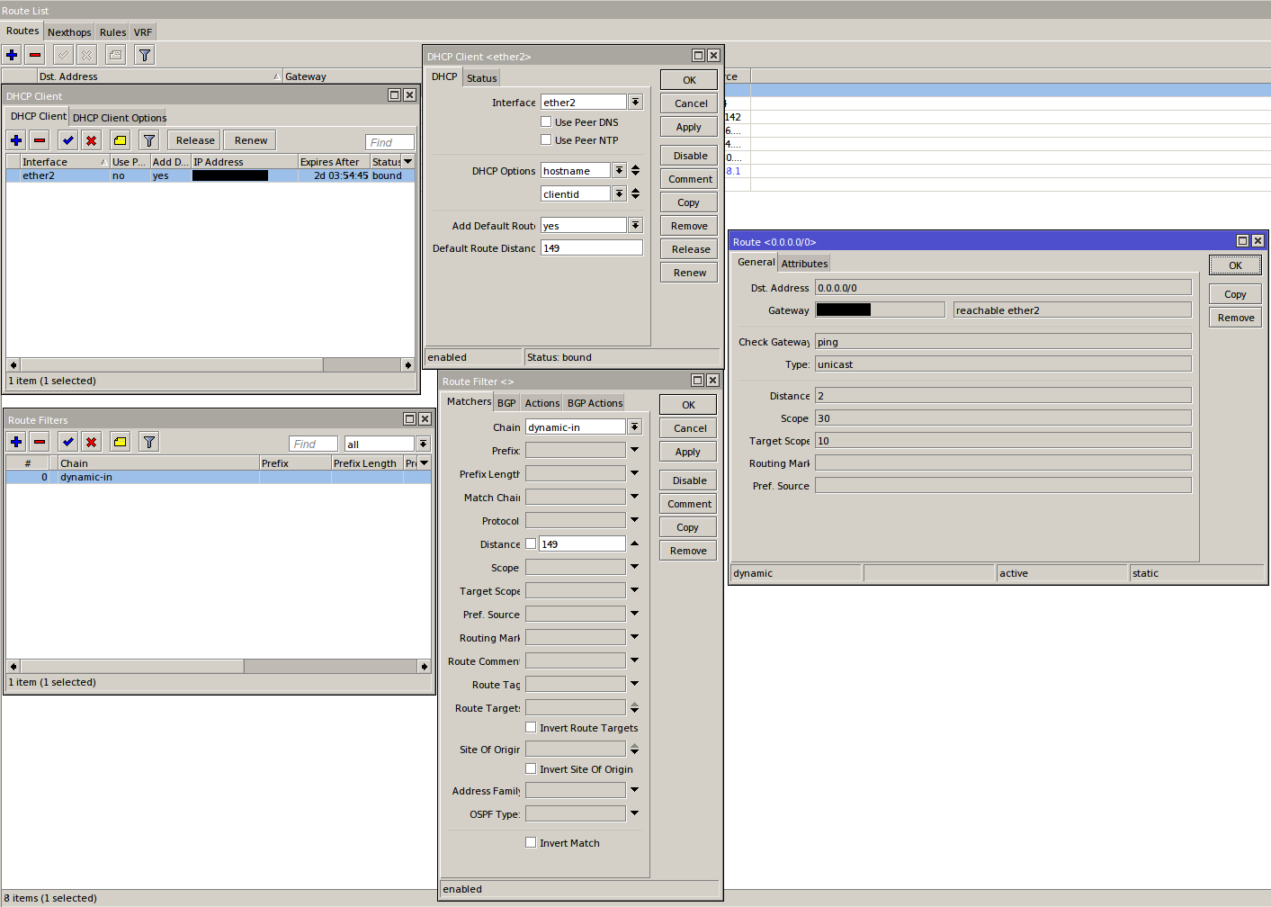

Nice. I did not know that filter rules based on routing triggers could be set. Thank you very much for showing me this. Now, as you said “Direct options in DHCP client would feel more user friendly, but this works too.”. @che: Also, thank you for sharing your script with us. I will go with Sob’s solution because this way is already implemented into the OS.
Best regards
Aleksandar

/routing filter
add chain=dynamic-in distance=30 set-check-gateway=ping set-distance=31
does not work? Please check
Confirmed (ROS 7.7-7.8 tested).
It returns “bad command name add (line 1 column 1)”.
As far as i know, this is no longer possible in RouterOS v7. There were huge changes in /routing/filter/, this is why you experience the “bad command” error. But even if you change the command to create a filter that is accepted, it will not work because chain “dynamic-in” no longer exists.
