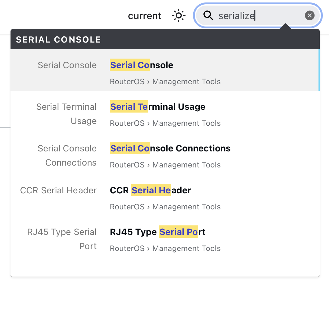

Another failed search: serialize
:serialize is mentioned in the Scripting doc pages, but was no found using the "search" tool. Also I could not find it in the CLI reference, now presumably since you're not cataloging scripting functions which IDK is the right call, since cross-references cannot hurt.
yes, confirmed serialize, so found another one. the indexer is not indexing some things, we adjusted the settings. it will be live in around 24h

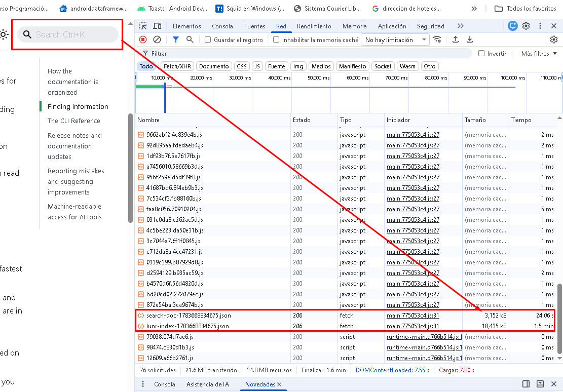

You'll note in web console for manual.mikrotik.com:
https://manual.mikrotik.com/search-doc-1783085448896.json
https://manual.mikrotik.com/lunr-index-1783085448896.json
and the lag from loading to when you can search.
The manual.mikrotik.com is build with https://docusaurus.io/docs/search, and you have to ask Mikrotik if they want to add some plugins to that to support url search.
The search is already a plugin (Lunr) and there is no way to do what you ask. I you can suggest a better search plugin, we will look into it. So far it seemed the best.

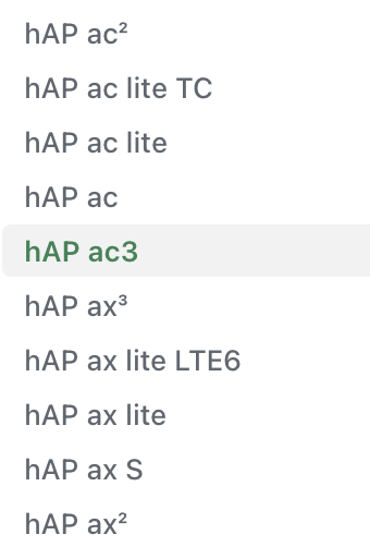

On the existing plug-in, you might want to look at how handle the "products names with unicode", since those are seemingly ignored/not handled.
e.g. a search for "hAP ax3" should display first, and if I uses its unicode name like hAP ax³, the hAP ax² appears first... which suggests the full name is not indexed.
Further, the hAP ac² is unicode, while the hAP ac3 is not. The latter hAP ac3 page does have a stray hAP ax³ in page body.
Side note, there are actually two ways to express the ² things in unicode since you can say it 2 made a superscript, or use the unicode char for the square/cube since they have there own code. The product naming page does not specify unicode conventions ;).
The amount of time I have to wait before I can start searching is truly absurd.
It is a JS browser client search. It downloads the index as json. The more documents the more it takes to parse on client side. This is very limited and "ship fast" solution. Better evaluate alternative search plugins. Personally I don't have Docusaurus experience, but I am familiar with several popular search engines. And from the available plugins I would try GitHub - tauri-apps/meilisearch-docsearch: A quick search component for meilisearch, inspired by algolia/docsearch. · GitHub first. Meilisearch is lightweight and a breeze to set up.

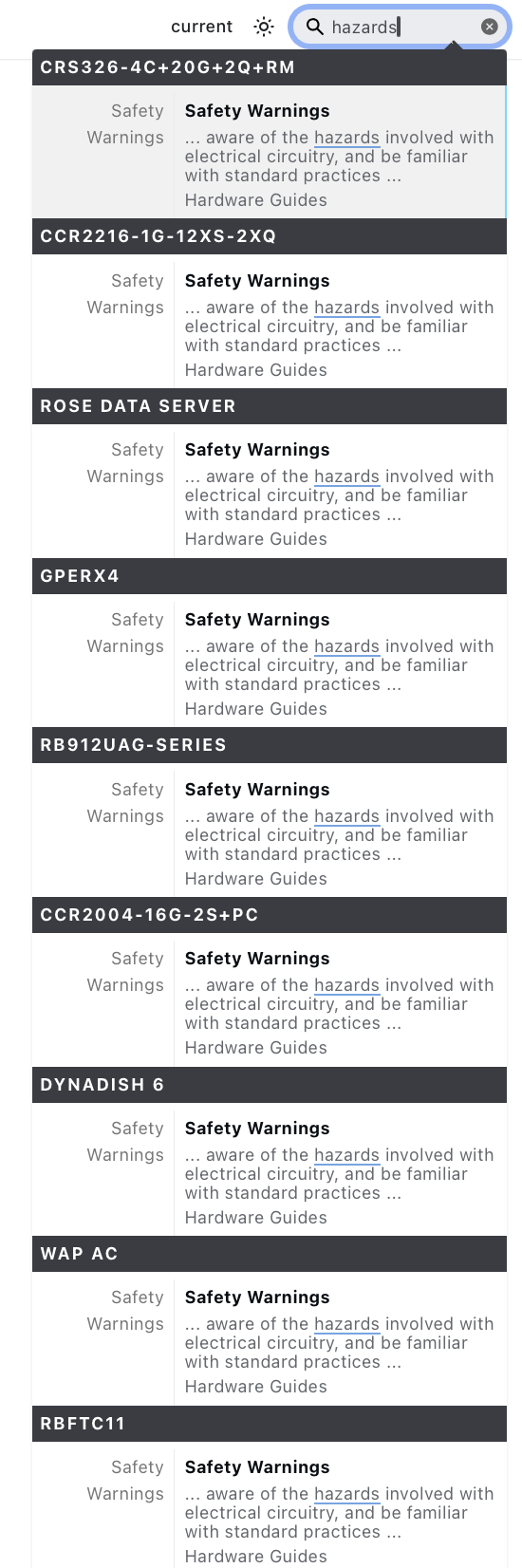

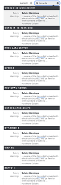

True, more content, more time to load the index. But MikroTik can control what's indexed. IMO there is no needed to index the whole of the manual.mikrotik.com/hardware/* since all the regulatory/safety stuff is getting index. With >200 devices, with many longer than "normal" pages... it's having an impact o the first-time load of the page and Lunr search index.
Now, the product names should be index, so the hardware page comes up in a search. I dunno if there some "ignore from index" in the MDX backend. But perhaps each /hardware page is a landing page (that is index) with the short summary of the specs (ports/CPU/mem/switch-crip), link to it's default-configuration, and link to main www page for the product - all which are not in manual.mikrotik.com today, but more useful that FCC warnings. So the current /hardware page with its "Safety Warning" becomes a subpage under each /hardware landing that not index.
