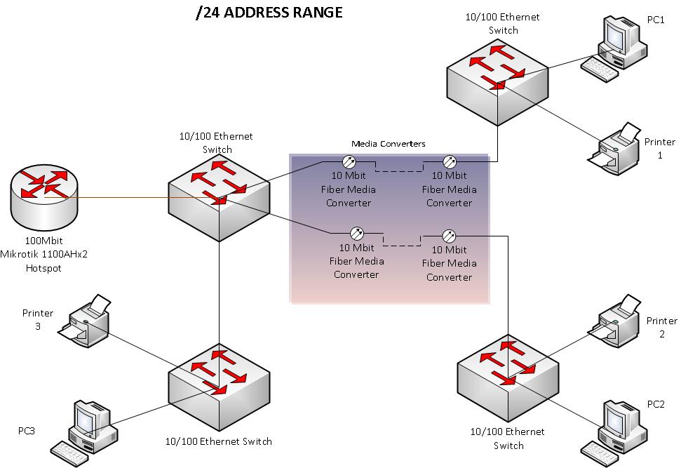

Issues with printing came about after converting the mikrotik router into a hotspot system.
I had trouble printing on printers 1 + 2, printing from pc’s 1 + 2. Surfing the web via the hotspot on PC 1 & 2 had no problems.
All printers are static IP’ed. Printers 1 + 2 (HP CP3525 laser’s) & printer 3( Hp 1510n laser)
Basically I had the network diagram below.
Initial testing would be that the pinging from say pc 1 to printer 1 would produce a one off good ping then the sequential ping would come back from the router(10.1.1.1) saying destination unreachable.
This was also emulated on PC 2 and printer 2, same issue and same result.
PC 3 & printer 3 had no issues printing.
Now the FIX after many hours of banging my head was changing the media converters to 100Mbit versions. Now the 1 & 2 printers print properly and all is well.
So what happened ? Why was it under 10mbit m/converters that say pinging from pc1 to printer 1, only produced 1 good ping packet and either the router coming back and saying unreachable or msg from the local pc’s ping producing an destination unreachable.
It was my understanding that under the same subnet pc’s/printers would not attempt to talk out to the router unless the request came from another subnet range.
Or is this a layer 2 problem with timings by having 10mbit media converters between 2 10/100mbit switches. And the router’s does `something’ when the icmp or other packet request doesn’t get answered in a timely fashion. ??
Once you are using hotspot, it tends to take over the control of the entire routing system. The PC3 and Printer 3 does not go through the Media Converter which is the reason they are ok.
10Mbits Media converter is not a passive element and same to the MT Router (100Mbits), so both of them needs to be same say 10 or 100. This is bcos M/Converter converting 100mbps to 10mbps has to make use of some packet compression ratio, in this process, some protocol that are not explicitly define for optimisation like icmp either get lost or least preference. That is why it is best practice to use same at both side.
This is my own understanding becos i have same problem with “MUX”, Gigabit Router and the only thing we did was to use same.
